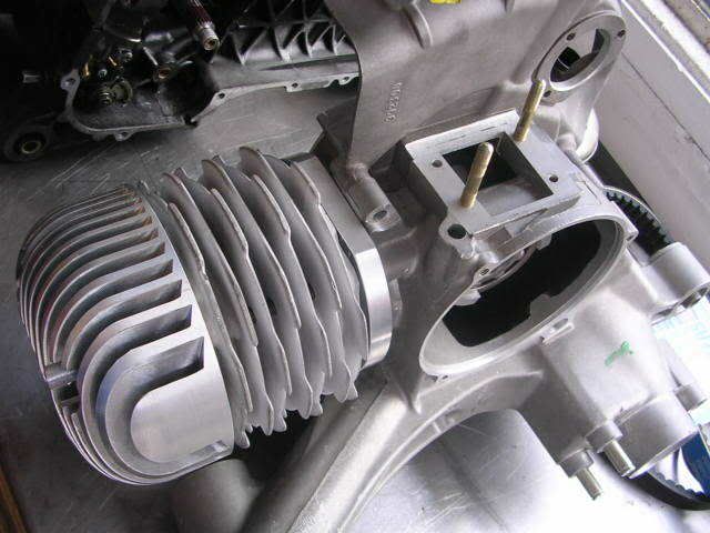

I did some work on some casings about 5 years ago.
LML reed casings, P2 crank, Malossi 172 T5 barrel. Would make a 190cc.
Packer bolted to casing and barrel studs into packer.
mick1
Posts: 1292
Main scooter: Li Avanti 225
Location: York
Looks nicely engineered, that's the type of mod' i'm thinking about (albeit with a lambretta barrel).
