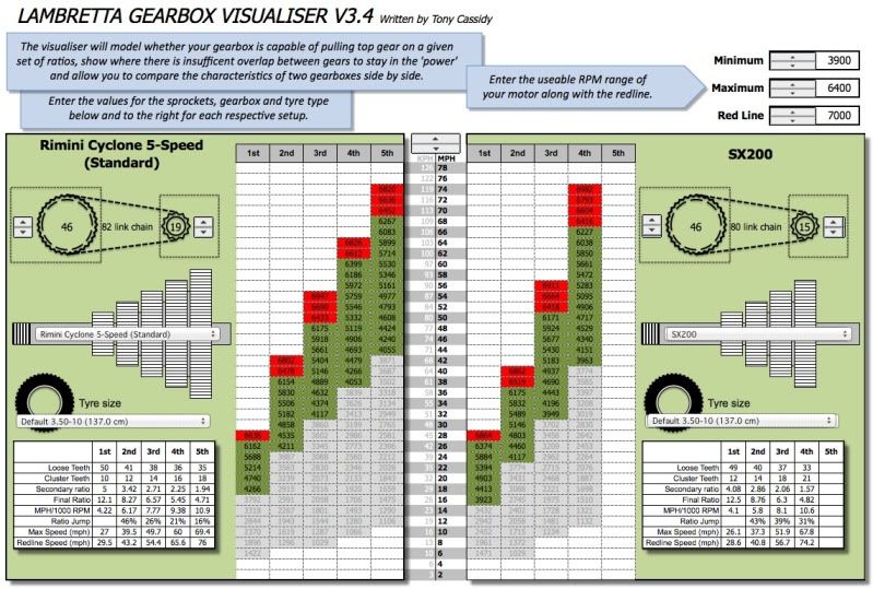

Thing is we've all re-tuned our bretta kits to the 4 speed box. So it is not instantly attractive.
BUT if you look at the 'power-drop' graph in the article closely, you see how much of your (4 speed) tune is going to waste. Also you also see how any kit would work so much better on this gearing with out the need for the 're-tune' to developmore torque to overcome the gear/rpm band limitations. The scootering 'graph' is over complex as it is overlays two runs, it is also too small to analyse at first sight. It also uses an un-typical LI125 box on the standard example with short 1-2 gap long 3-4 ratios But if you spend 20mins 'unravelling' what it represents, then you see the gain, or better said 'lack of drops in power delivery': I bet it is a joy to ride.
I would not get all the benefit on my 250 Special from it either in it's current form, as I also re-tuned for a 4 speed box. Neither can I afford that price tag. Would not mind one though!

I really hope it's robust as it's the upgrade that gives everything and probably needs riding to fully appreciate.
The benefit from significantly increased overlap can't be underestimated.
It may be that some of the bigger capacity 30BHP+ motors can cope with a 4-speed box but for a standard or modestly tuned motor, this would have a real benefit.
This shows the comparison between the standard cyclone and an SX200 box - I know which one I'd rather ride.............
