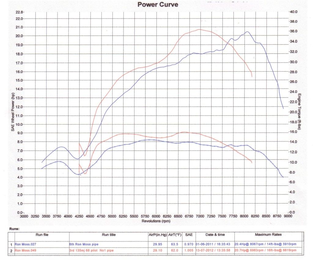

This graph shows the NK Road making (RED) 20.6 bhp @6238 rpm / 18ft/lbs @ 6147 rpm
Against the
New prototype Superclubman ( not the final one) 20.7 bhp @ 6983 rpm 16 ft/lbs @ 6619 rpm

To have a better comparison on the New clubman,
At the 1/8 mile sprint at Lincoln on Saturday Matthew Clarke had his TT3 there:
set up 60mm crank = 230cc
4.6:1 gear ratio
30mm Dellorto
Well known expansion box
Engine run in
Best run 65 mph
My TT3
225cc
4.6:1 gear ratio
30mm Dellorto
New Clubman
65 miles on the clock running rich
2nd run 63 mph
