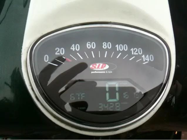

Yes got instructions. Seems to be working ok, fingers crossed.
Worked fine to Modra and back. Scooter 10mph slower though!!
Anyone know what temperature it should be running at though?

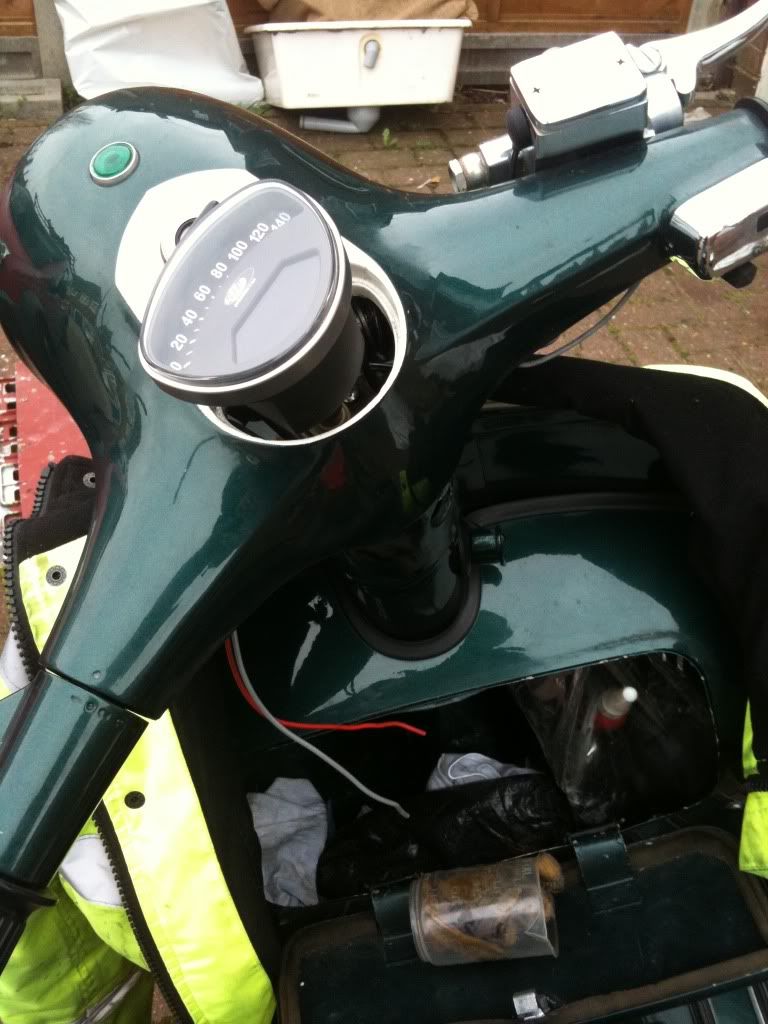

Here's one of it fitted :)

Magoo wrote:Scooter 10mph slower though!!
Looks like it's already running 20kph to fast!!!
I think thats the rev counter bit! :D :cry:

Correct, the MPH is shown on the digital read out and what would have been the speed on an old type speedo is now the RPM. ;)
