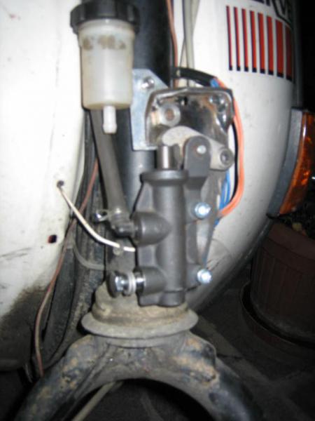

thats what i want, the orginal look for my tv!
as master cylinder i use a TPH cylinder
this cyninders are working very well
for example, the TPH-Cylinder in my serveta
