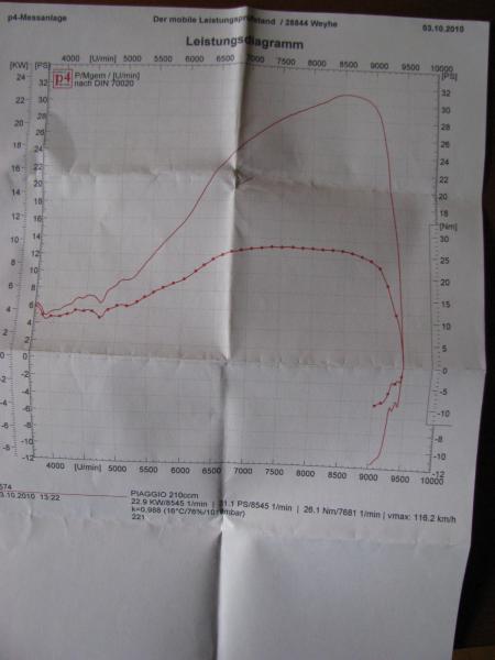

i made a little misstake - i wanted more power ( 2 weeks ago ): after porting the cylinder nearly 140/196 driving trough town sucks. the carb-setting wasn´t good at all - i lost about 4-6 hp
look here - germany rotenburg 3. oktober 2010 - dragracing :
my run - at 0:41 seconds:
http://www.youtube.com/watch?v=yfaoJ75v ... r_embedded#
now down on 134/195 - the power came back, but not as good as before, i need a new cylinder - carbsetting now: 35 mikuni with 57 needle 2. clip, mainjet 290, "other jet" 17,5 - the engine runs now till 9600 upm and have about 36 hp with a better bandwitch than you see above - a new dynorun will be posted in a few days
i think best timings for this machine is 131/195
