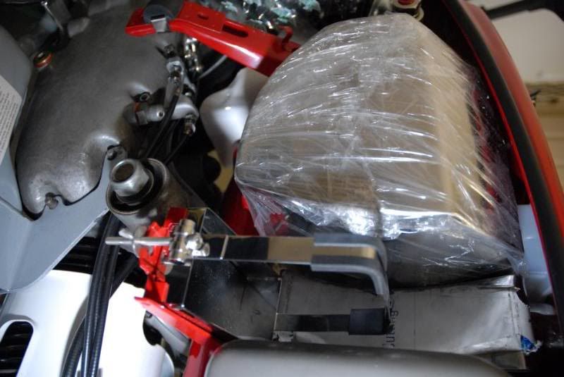

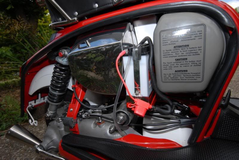

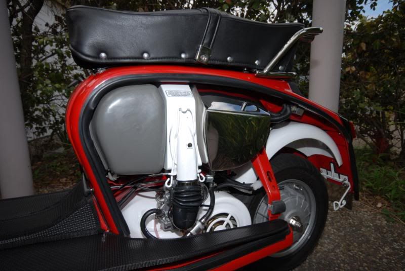

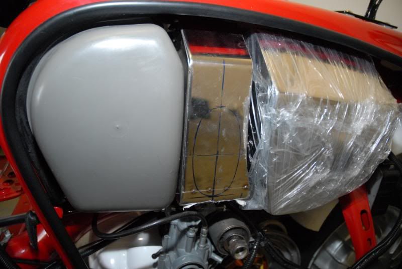

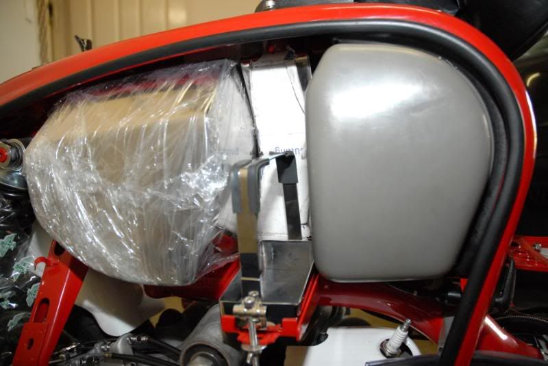

Maybe not quite a 'long' range tank,maybe a 'mid' range, anyway this is one I made for myself at work, 316 stainless, kinda fills the space better than an original tank, agree?
A couple of tips;
Cardboard templates,even a cardboard model, to make sure it fits,
Take your time butting your edges together,should be inside edge to inside edge, if that makes sense.
Also, when it comes time to weld,purge it.

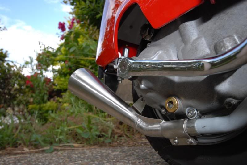

That's an 'interesting' exhaust pipe...

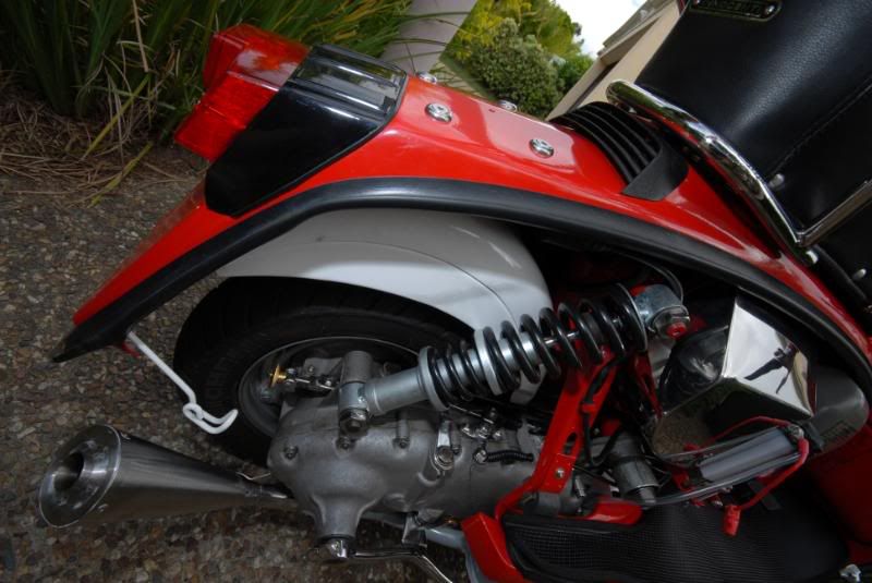

red ghost
Posts: 545
Main scooter: lambretta gp150
You like that?, I looked at the ancillotti 'retro booster' and thought I might try something different, so what you see is a bit of a working prototype I made at work, so far it dosen't affect performance,keeps the same tone,just takes a few decibels off.

Show off :D Did you pass inspection?
