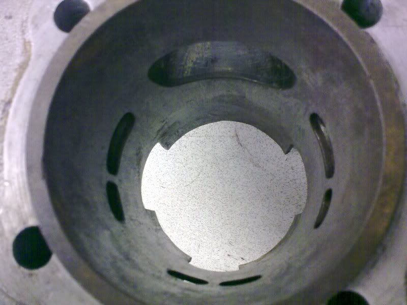

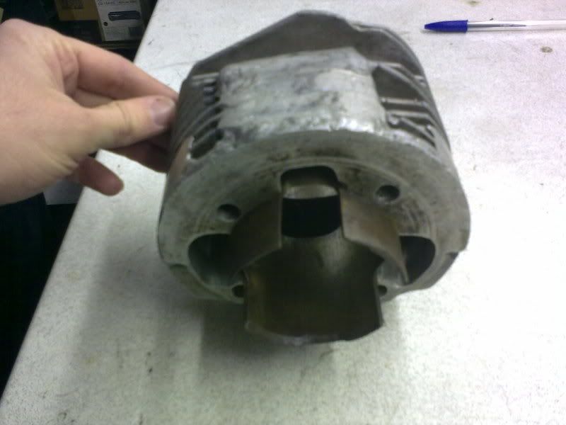

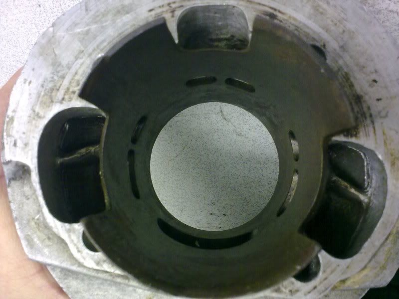

He aslo had a spare cylinder so we took some pics.....considering the conversion work, the rest of the ports were surprisingly tame......interesting project though, and nice to see something different:

Can you post pictures of the work that was done?
