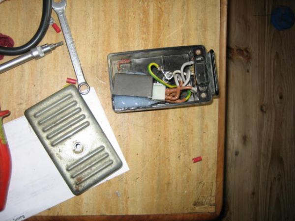

some folks posted this in a german scooterforum and i think its a top tip and far too good to be missed for english speaking lambrettisti:
6V battery-system and troubles with your original rectifier ?
get a modern kokusan rectifier. electronic and very small it fits in every series 3 or series 2
rectifier-box and works perfectly.
price: about 15.- gbp
you can get this for example via: http://www.zundapp.com

the rectifier on the pic is from a varitronic and 12v
the kokusan rectificer is a little bigger, but it works...
That doesn't look as neat as the one J1MS renovated and posted up on here a while back....It involved a Maplin rectier.

But this one is wired specifically for the varitronic stator.

Just a thought, but is there a possibility of that little regulator getting rather hot once the other half of the original box is fixed back in place????
Never really checked a regulator to see if they get that warm, but the aluminium finning makes me think that it's good to have air flow over them...

You're probably right, on the original 60's conversion they drilled holes all around the box and later decided that the rectifier would be better outside (exposed).

i have mounted a 6v kokusan rectificer in the orginal plastik box, an it´s working realy good in my s2 with battery an orginal loom
