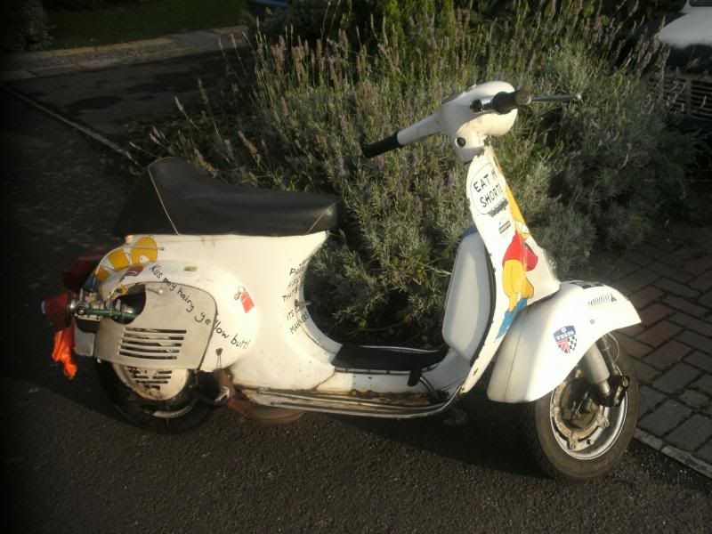

ducksta wrote:Image
position at present
If the manifold is matched to allow it to flow properly I don't see why you can't.
I have a 25mm on this:
And an SS90 rep with a rear facing 32mm, both work fine in the wet as well :)

No problem running backwards. My TS1 P Range has a rear facing carb.
The Quattrini 172 kit also does.
