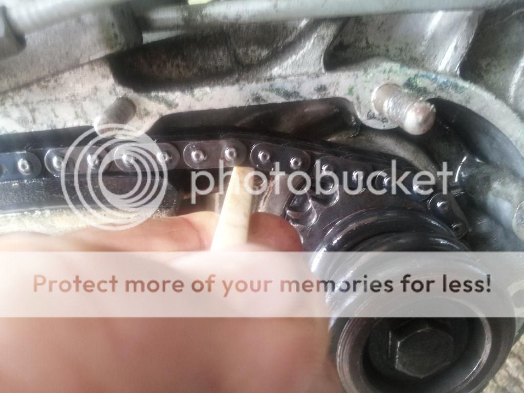

I use the thicker end of a plastic chopstick (free gift with some scooter parts !!) and measure here.
http://i1023.photobucket.com/albums/af3 ... 125416.jpg[/IMG][/URL]
