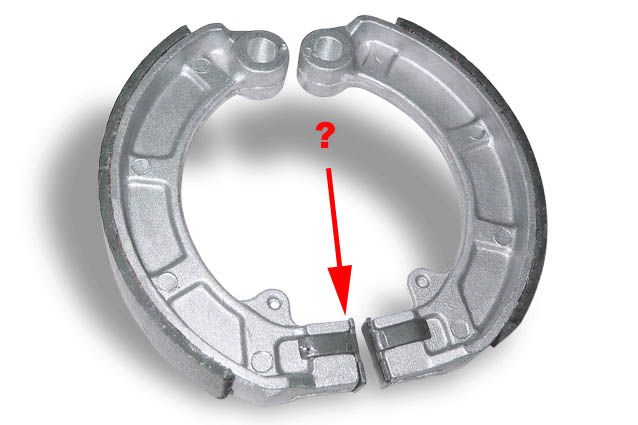

eh?? off the actual face of the shoe that makes contact with the cam???
Donnie.
djh66
Posts: 369
Joined: Sun Jan 31, 2010 12:19 pm
Main scooter: 150 special
Location: Bedford UK
Donnie wrote:eh?? off the actual face of the shoe that makes contact with the cam???
No, no, no...the end of the shoe, that makes contact with the cam
Bring Me Sunshine COYH
Donnie
Posts: 1038
Location: Bedford, UK
As in ........
Donnie.
djh66
Posts: 369
Yes that's correct. Done that tonight, hub now fits over brake shoes :anbrgin; However, this is where I encounter the next problem :x
The 8" hub now rubs on the brake shoe pivot pins! They don't tell you things like this when you buy products, I expect better from SIP. I suppose I'll have to skim some ally of the pins so they clear the hub.
