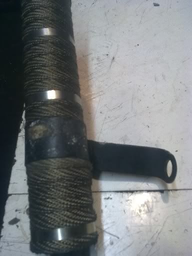

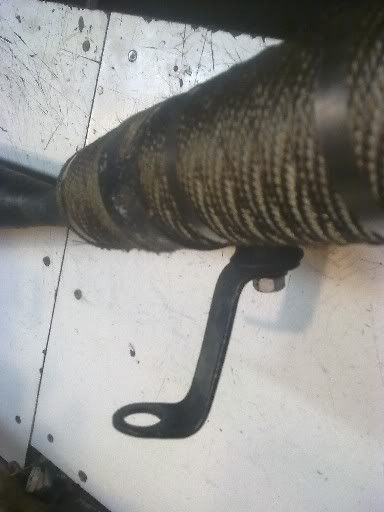

best i can do at the mo ,but its just a flat section of steel bolted to the shock bolt ,you can see the rubber mount under the end pipe
my end can bracket :
there's a metal strap round the can that fixes via a bobbin to the bracket :
If you're starting from scratch, get the pipe where you want it and make a bracket to fit.

byron wrote:my end can bracket :
Thanks Byron thats great although my exhaust has the bobbin welded on and is further down the pipe.
It looks the same as the picture but is powder coated black and appears shorter,so im not sure which model it is.
