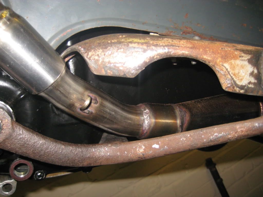

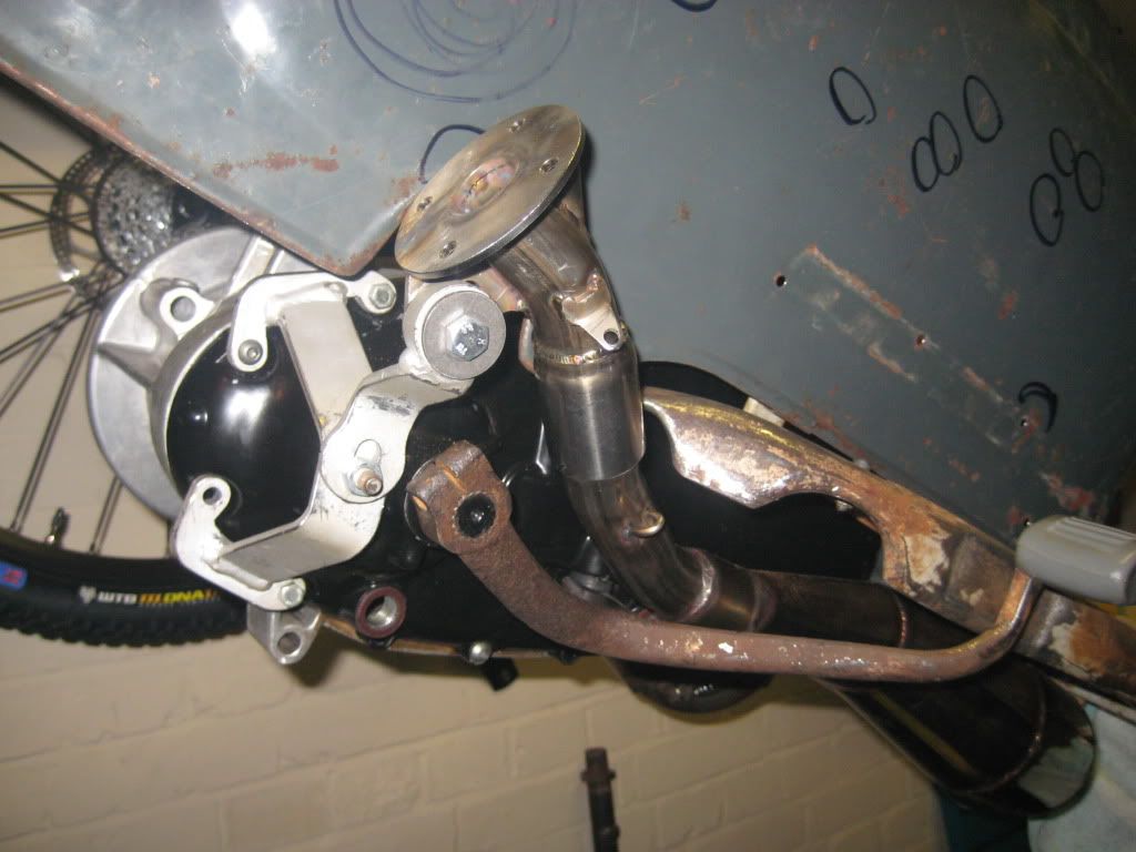

I have a Devtour on mine and its fits a treat ( only a small cut out needed)

i run a series 3 jl on my gp225 in my series 1 and it fouls the panel slightly.
all expansions will fit all li style engines

i ran a scootrs s3 type pipe on my s2, i had to cut off the end of the floorboard (as far as where the bracket sits) and i was running a stiff (R6) shock.. and it did rub slightly on the lip that goes round the kickstart cutout in the panel.. it rubbed a groove in the alloy end can and also took the paint off where it touched the panel..
thus it was not perfect, but useable..
my understanding is that the difference in s2 and s3 type scootrs pipes is where then can sits, and thats it..
any pipe should fit all s2/s3/gp engines, its just where the bodywork sits that is the issue..
