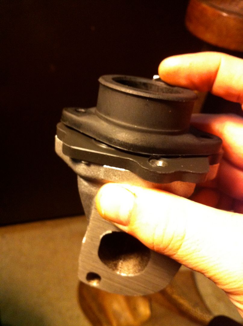

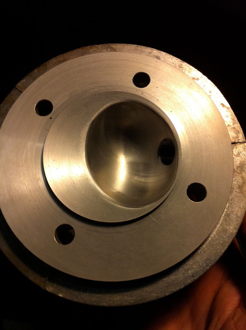

I received my new mb head, piston and lth reed manifold.
head is a nice piece of work:
Forged piston with wiseco rings: nice piece too:
lth manifold: good but loosy:

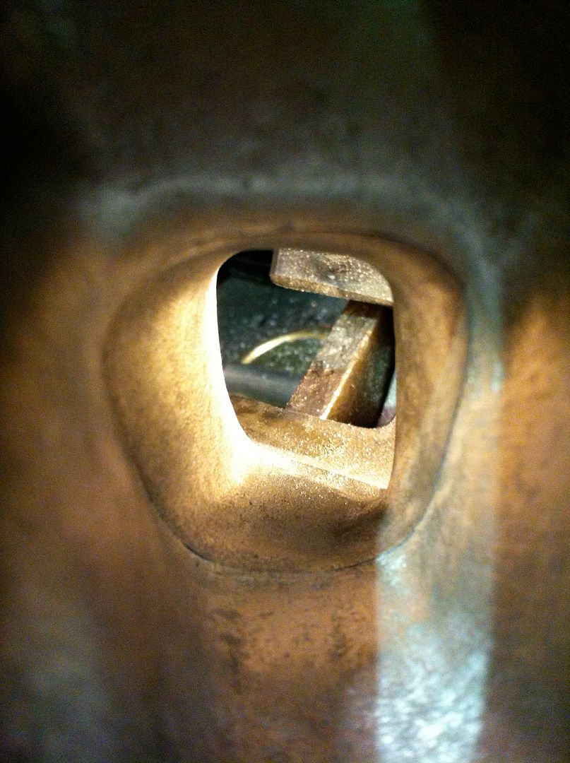

casting and fitting: fine, you almost don't need to cut fins. But rubber manifold is a crappy loosy (just 2 bolts) item which doesn't match the reed block. Sealing it will be a pain. I've read lots of comments telling about air leaks issues... I'll think about it. Maybe doing an in-between-plate to inlarge both sealing surface.

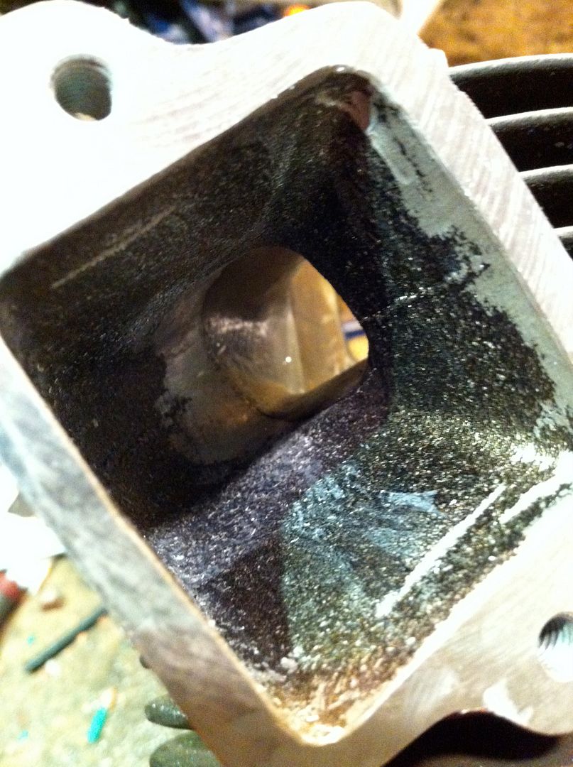

from inside: needs a porting:

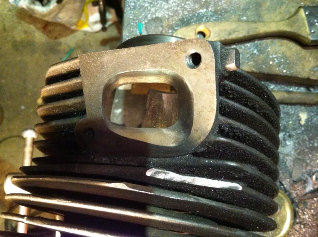

almost finished: passed and flowed

manifold out:

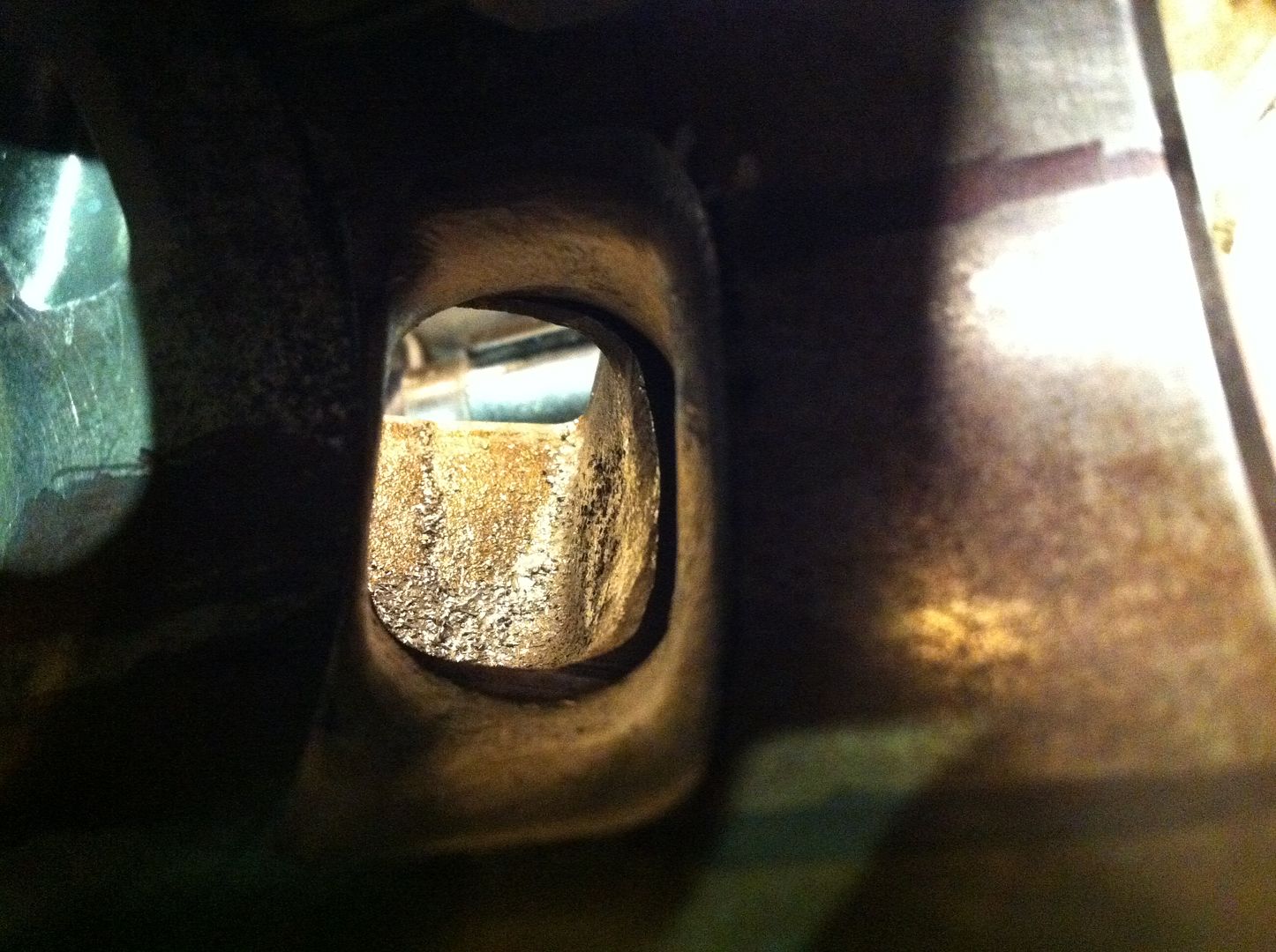

The 2 boost ports will settle somewhere between those 2 black lines (figuring peg runs) and center by the black mark.
