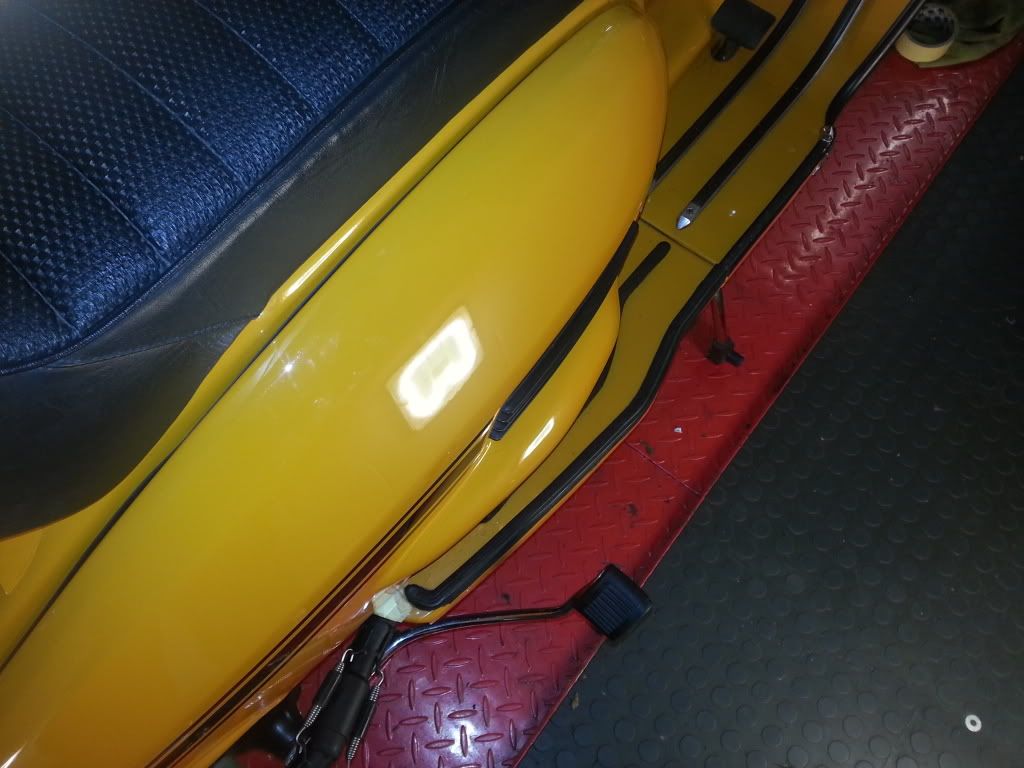

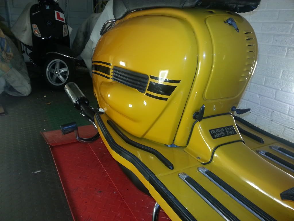

WINTERMODEL150 wrote:Ok,this is what I ended up with after modifying the side panel so I can now run an LTH air filter under the panel.
All comments welcome!!

i use a lth manifold with a 35mm mikuni under gp panels with a cam lam sweetbreathe filter, this setup does not touch the panels and solves the fuel spitback issue, ran this for over 2k miles without problems
nelson pk
Posts: 515
Great idea with the mod on the panel there!
The breathe sweet is good, i run it on a monza with a PHBH and it just touches the panel slightly.
The real problem is when you want to use the filter with a mid range fuel tank and toolbox or a long range tank. The filter then has no room.
This is why i'm removing the standard toolbox and going for a legshield toolbox on mine.
This will then give the filter plenty of room.
