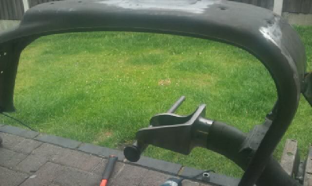

frame is now cut,i thjnk rocho's done a great job with the plasma cutter,
new mount is in the frame ready to take the engine
the engine will sit back about 50mm

chris cspe wrote
I had a GP with carbon body work,the engage was over 30hp and a bit of a hand full under hard exceleration, the engine mount tube and the shocker pin got moved back 6 inch. The area around the number plate was cut out and a strip of metal about 3 inch added on then the piece that was cut out was welded back in-place. The handling was improved no end, not just when excelerating it just felt better to ride. You couldn't notice at first that the wheel base was longer. (full bodied) the air filter sticking out the middle of the side panel was a bit of a giveaway though.
That was this one Rickspeed.
the awesome psycho gp,excellent bit of kit,hope this turns out as well
