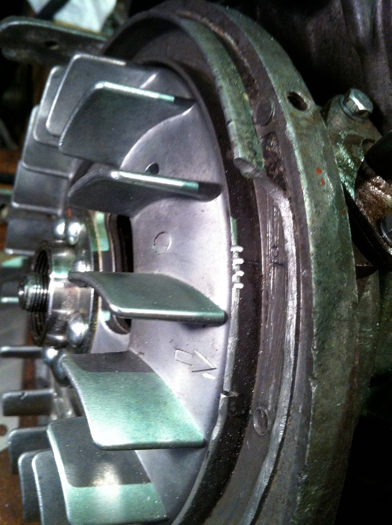

TDC and from U to D: 22,20,18 16°

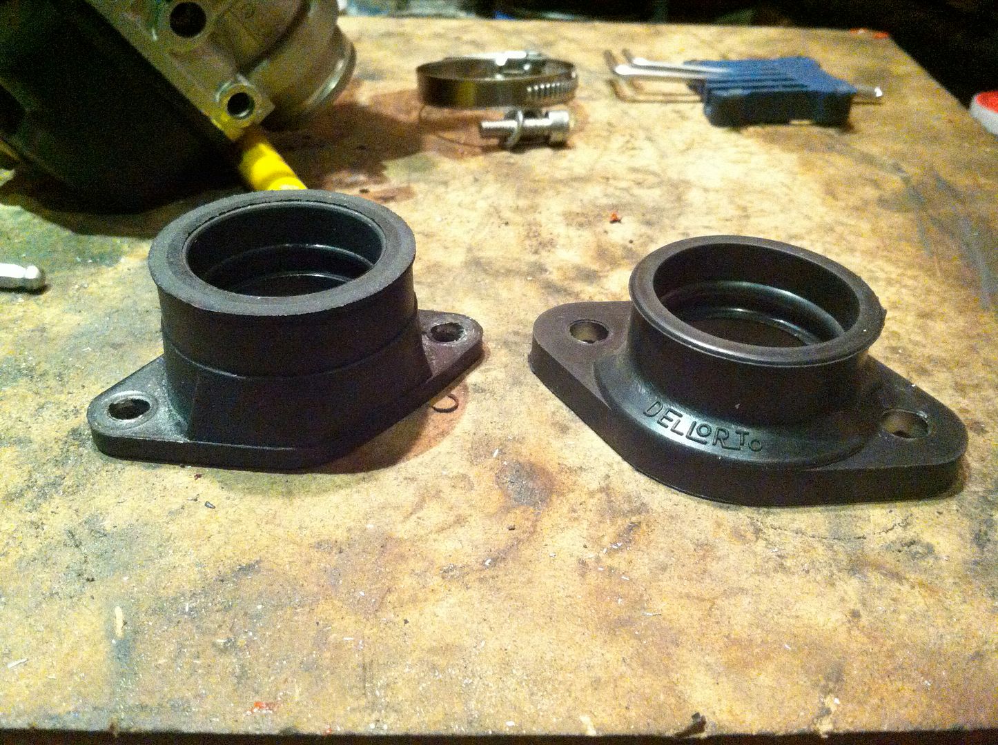

new items arrived:
rubber manifold dellorto shorter than the one sold by stage6

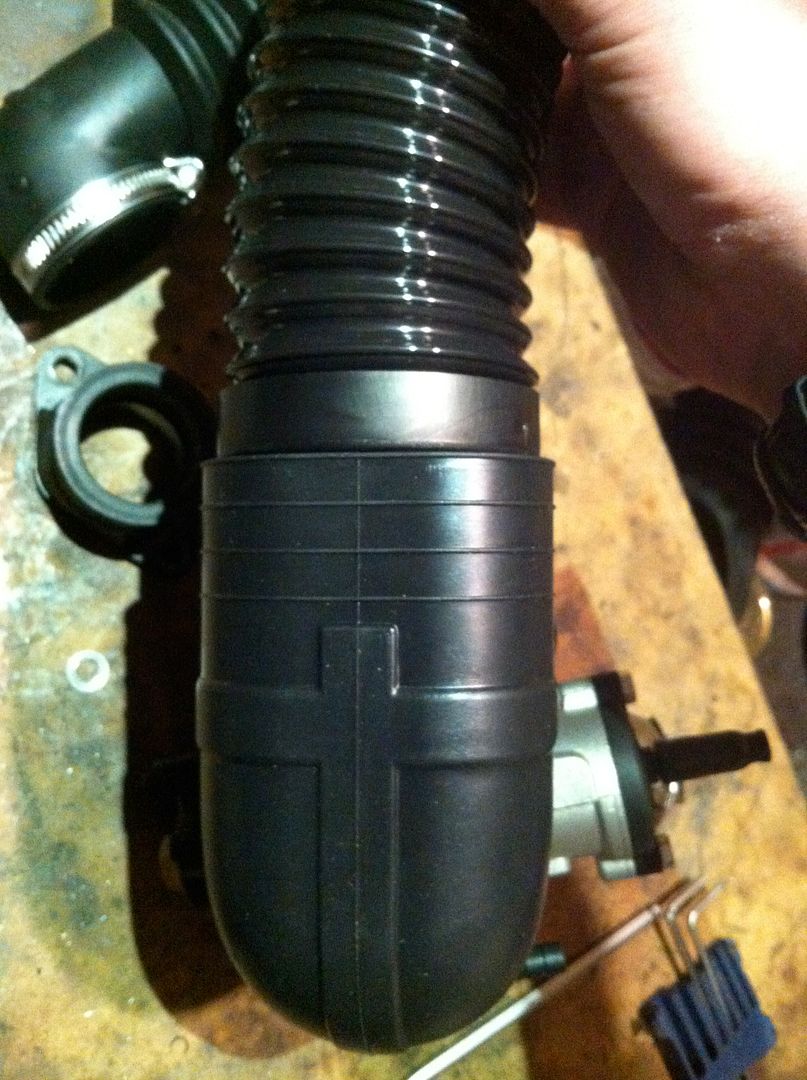

ramair and evergreen: With an 60mm ext tube for junction it' ll be stiffer (evergreen is very soft) and sealed:
And now the big issue: I guess the whole air duction system is larger than what side panel leaves :| Somebody knows the space between engine mounting and panel??

Adam_Winstone
Posts: 1693
That's great info about the shorter rubber manifold mount, thanks. Where did you buy yours from?
Anyone know who might sell them in the UK?
Adam
fastfrog
Posts: 412
Location: Paris, Taxes
http://www.stein-dinse.com ref 10577-82
Ach! direkt von Deutschland!
Size matters!

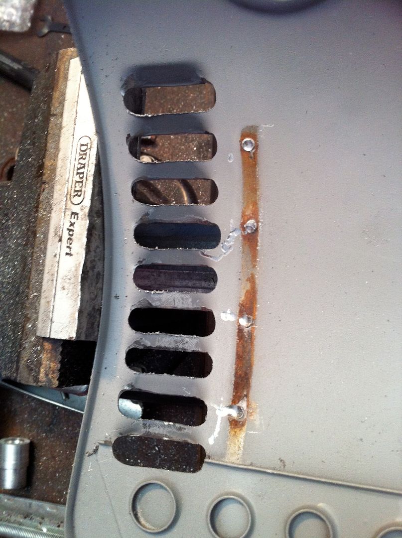

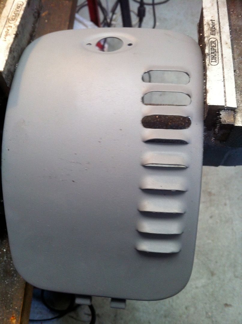

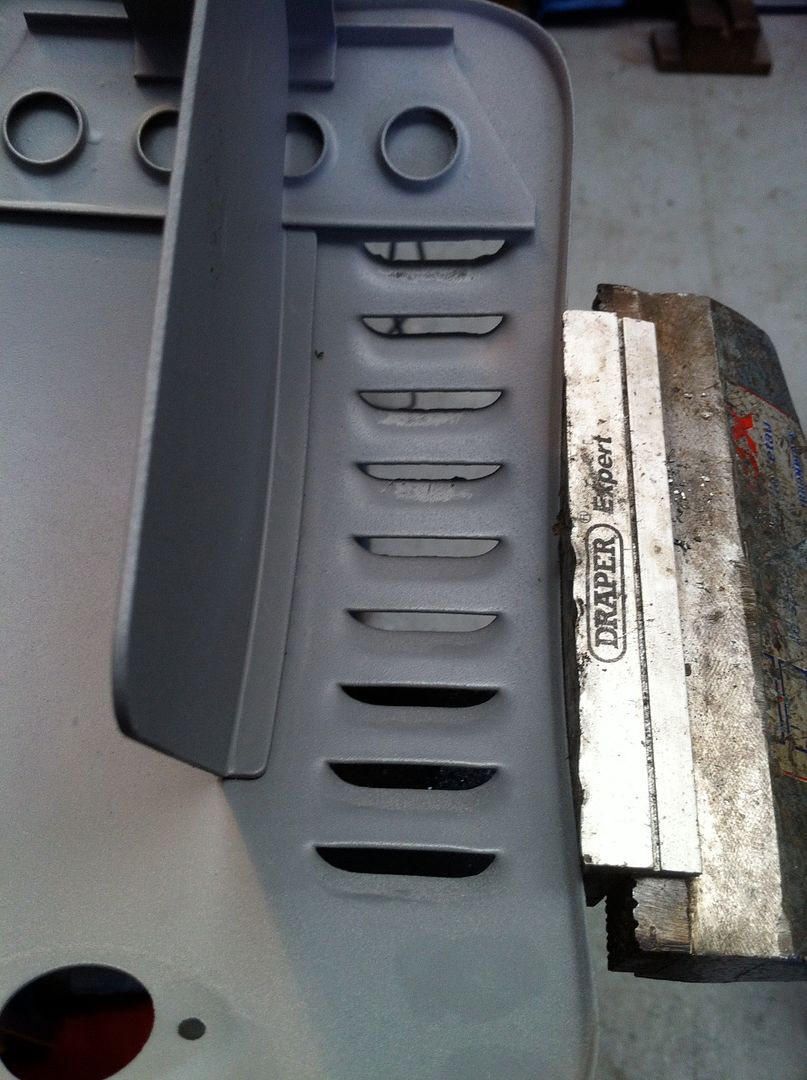

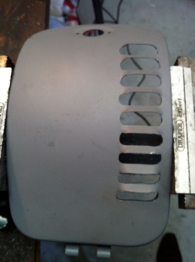

tool box panel dremelized:
it needs still a little smooth but it's close to what I wanted.

Adam_Winstone
Posts: 1693
fastfrog wrote:http://www.stein-dinse.com ref 10577-82
Thanks for the link.
