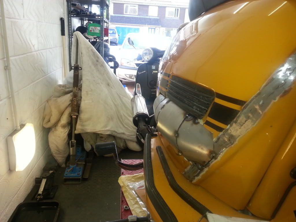

WINTERMODEL150 wrote:Hi,got an LTH filter fitted to my mikuni 35mm with an mb inlet and this is how far it sticks out.
Looks good, got any finished pics Dean?
I will put some finished pics on here for you to have a look at this week :D

Ok,this is what I ended up with after modifying the side panel so I can now run an LTH air filter under the panel.
All comments welcome!!
Dean
Posts: 4823
Location: Lanarkshire
Nice, I like that and the jet door.
