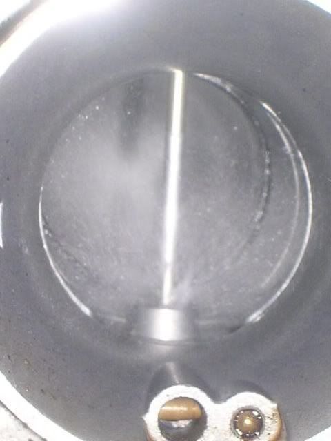

Ever seen one this bad? Update. It gets a lot worse.

wack 63 wrote:The bad thing is you can replace the slide etc but I think the plastic guide in the carb is not available so the slide still rattles around,but I could be wrong.Where was your mate riding ,a desert?

Thanks for that Leigh,just that I was told a while ago by a well known dealer said they weren't available and sold my mate a brand new carb instead. When I had a scoot dynoed with a Mallossi filter it made 14 hp then 17 removed so it proved to me that they do restrict air flow

I've never run a filter on any of my kits and have never seen that kind of wear.
Maybe if lived by a quary.
