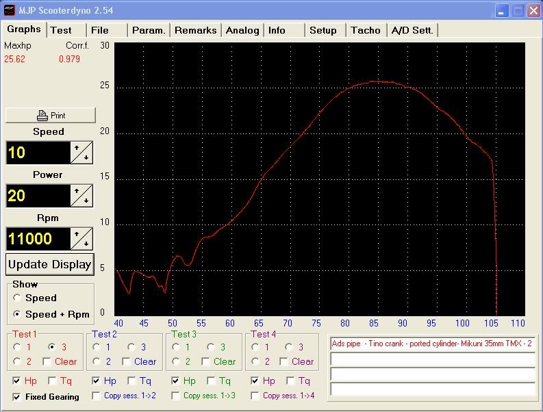

We had the chap that owns the tuned Muggy at our spot the other week, nice chap called Spike, so i offered him a free power run just so i could get some more data for you guys....similar graph to what Ads posted before, but slightly lower on peak bhp.
His engine seemed to stutter quite a bit at low revs, Spike said he thought the head might be blowing a bit, so i advised him to look into that ASAP, the pipe (A/F) also seemd a tad weak on the over rev, but if its working for him then that's good.
Anyway, here's the graph:
As soon as Ads drops me off a test pipe, i'll do some back-to-backs on JL4's and other pipes to get some comparisons. ;)
