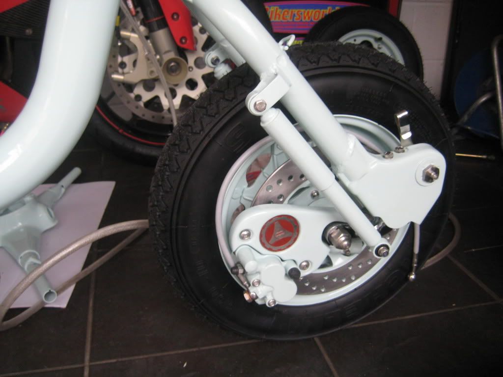

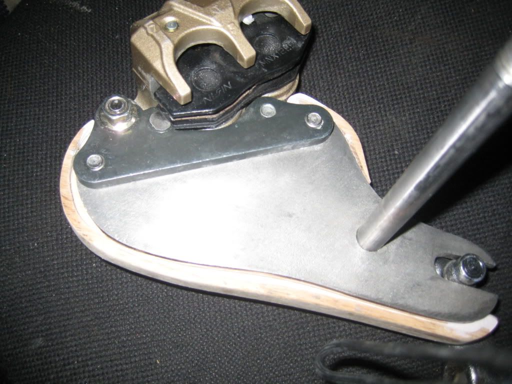

thanks carlos , heres how i made the disk brake cover and rev counter holder !!!ImageImageImageImageImageImage
