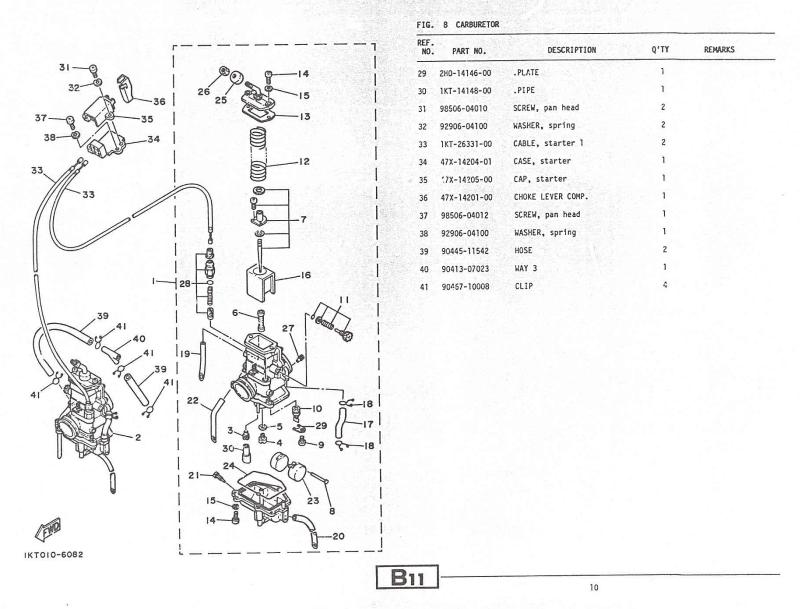

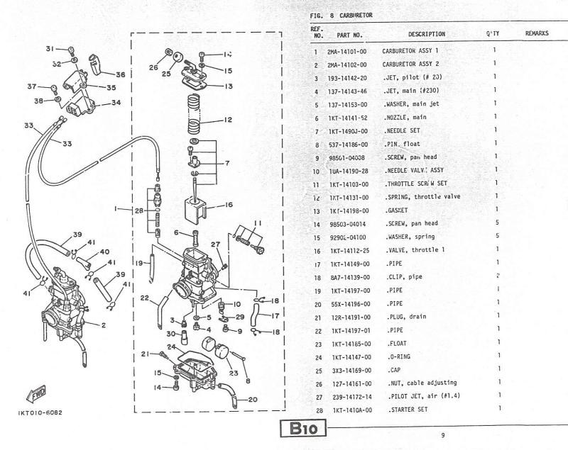

A very similar carb is the mikuni TM 28 as fitted to the 1987-89 yam tzr250, the diferences are: it is a 30 dergree down draft carb. has a power jet, no air screw. these carbs are easy to set up
If you do pick one of these up it will almost certainly need a new float needle and a float bowl gasket, a few £
If the emulsion tube and needle need to be replaced look at about £40, but these do tend to be in good condition even on very old carbs
mounting details:
spiggot size is 35 mm od, with a groove for carb rubber 3mm from the end of the spiggot
the part numbers are the yamaha part numbers
mikuni parts: try NRP in manchester.
http://www.nrp-carbs.com
email [email protected]
