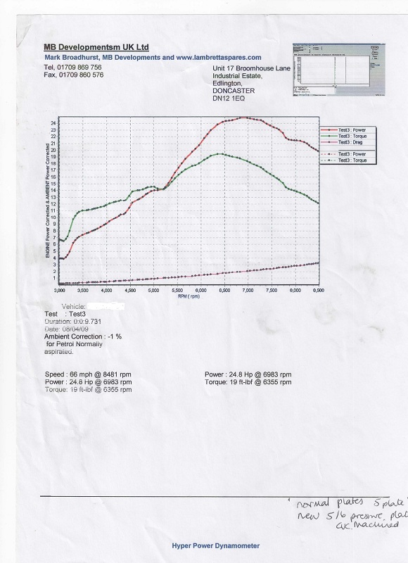

Here you go..... RT255 with Tino Clubman versus an RT230 with same pipe..... this is BEFORE the fitment of the reed valve, and extra tuning work:
cezeta
Posts: 1104
Location: Windsor UK
thats looking good to me, give or take a bit for dyno differances.....this is exactly whats needed. why fanny about with small cc revvy engines when you can have a "lambretta" with plenty on tap to go places 8-)

cezeta wrote:thats looking good to me, give or take a bit for dyno differances.....this is exactly whats needed. why fanny about with small cc revvy engines when you can have a "lambretta" with plenty on tap to go places 8-)
Well its been a while since I've been on so just for you Sean I'll bob a post in!! ;) :D
Cezeta why is that any better than any MB touring TS1. For example below is one posted by vespanic on this very forum, from the same engine builder, presumably dynoed on the same dyno. If you check the HP and Torque figures every 1000rpm there the same upto 5500rpm when the little old TS takes over.
RT255 engine cost quite a lot I would think, feckin s**t loads hey, more than a standard stroke TS??
So why is the graph for the RT exactly whats needed in your opinion?? Is this the four stroke feel you were after......
Please Note:I'm not trying to compare the two engines as they are different I know.........

if you want a piston ported scooter with a clubman then a piston ported engine with a clubman is so much better that a ts1 with an expansion. not everyone is looking for the same thing, the last few posts were about "standard" scooters with decent power as apposed reed valve, expansions and open carbs.
they are all there to buy but for a classic scooter with a clubman then the rt is the one i like, im sure something similar could be created elsewhere but for now all the boxes are ticked by the tuner that we have never been let down by in 20 years.
