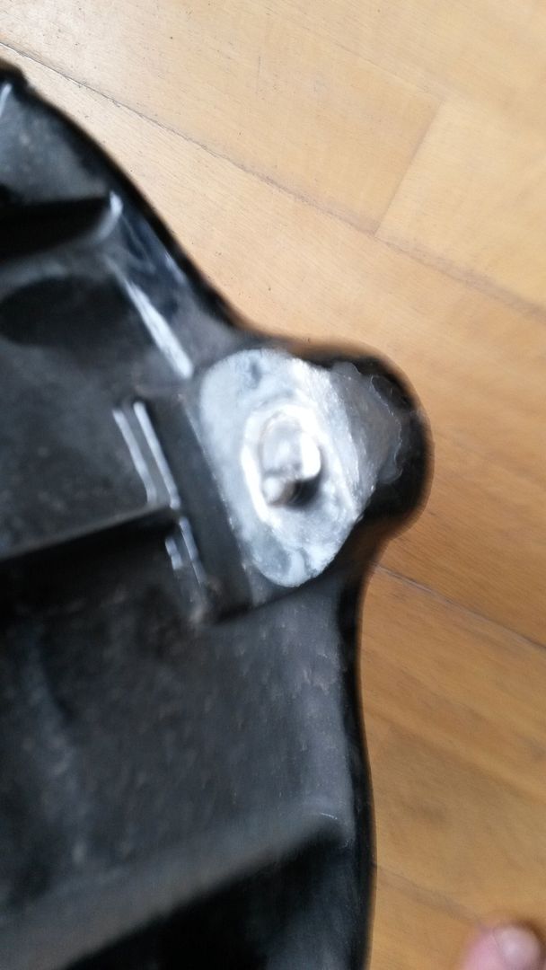

Felt a rear wobble on the A63 coming back from Cleethorpes. Thought i'd got a flat rear but all looked well when I managed a "controlled" stop (spooky at 60 mph). Further inspection showed all four of the wheel studs had sheared. I'm puzzled as to the cause ?

Last year I noticed a knocking on mine and inspection revealed ALL 4 hub studs scythed 3/4 the way through. It was due to nylocs not gripping. (Normally I discard nylocs after 1 on and off but this time I hadn't.) Holes on tubeless rim had elongated and had been rocking.
How are the holes on your rims?

Loose nuts are the likely cause I'd say.

I had the same in france, about half way through an 2 missing nuts..... i didn't realise but it seemend to slightly knock unless i went faster! .. so i did :? i only noticed when we stopped for everyone to catch up!
but its the nuts loosing up, just enough for it to move, and once the rim holes ovals,it moves it backwards n forwards cutting the studs, always double check n replace nylocks now... plus thick paint or powder coating rims tend to soften/wear n cause it?

Domed hub nuts that bottom out before properly gripping the wheel?

I've done about 300 miles since a full re-spray so suspect the paint on the rims/hub may be the cause. I reckon the paint flaked away (or softened) after tightening and left the rim loose on the hub, then the rims sliced through the studs.
Out of interest I checked the nuts that hold the rims together and got another half turn on all of them.
The rim holes look worn and a bit ragged but not elongated.
New studs on order and back on the road for less than a fiver.........I hope !!
