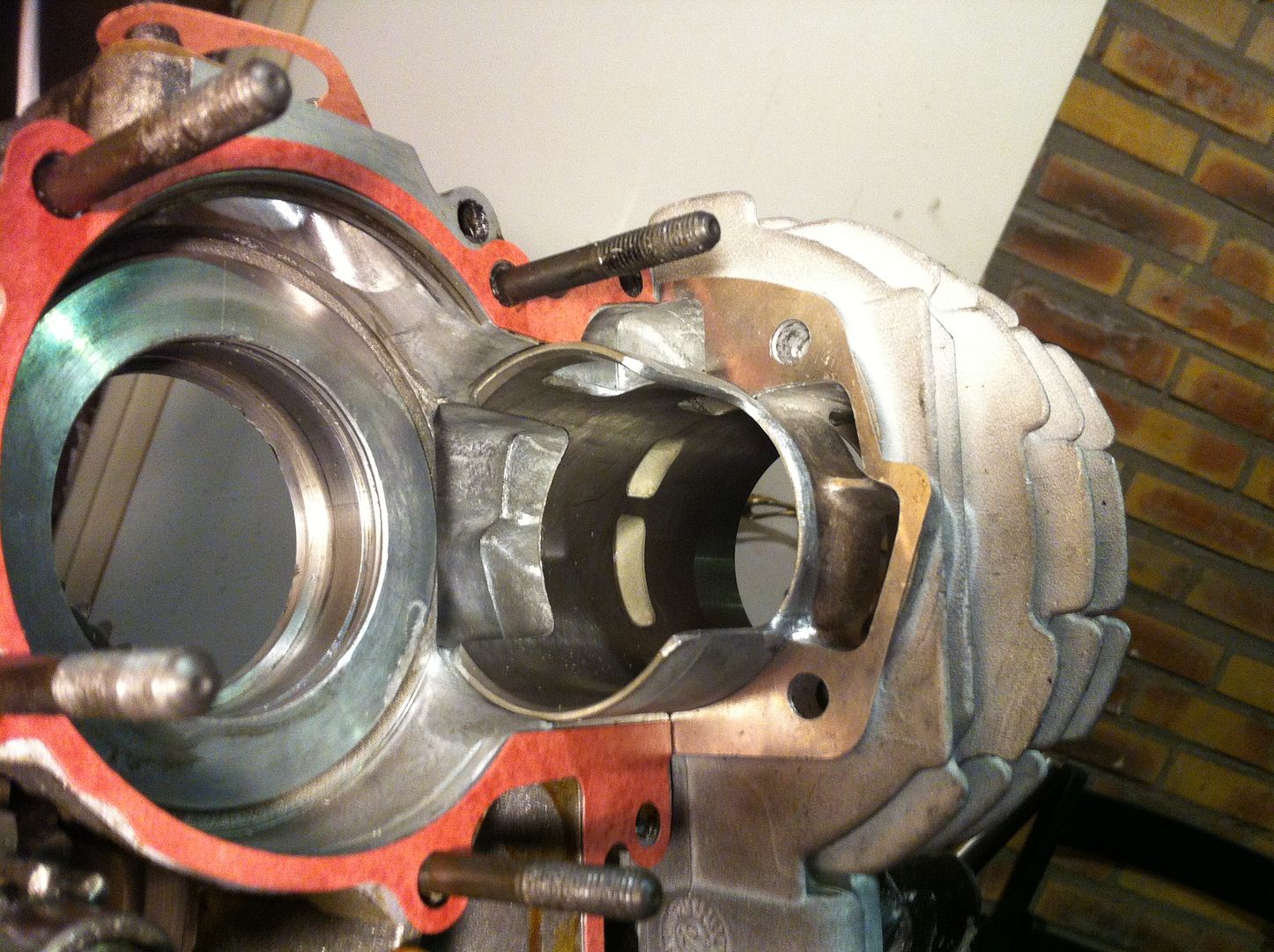

lightened FW downed to 1,6kg
Engine is now running fine and fast for almost 6 months. No engine issue and great power poured thru the whole rev band. A gaz mate!
I'm already working on a new T5 project with a Malossi bold on. Engine is waiting for its lightened flywheel too.... Thread on T5 STSCI....
This one is a monster:
Size matters!

Do you think removing the casing transfer dividers has a benefit? I have removed them in the past but don't bother now .
fastfrog
Posts: 412
Location: Paris, Taxes
no real choice with the malossi. Dividers are out deep in the barrel....
