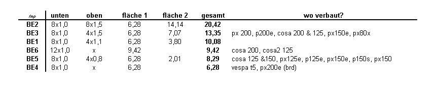

Which is in line with chart posted above which suggests the BE2 2/4/7 is leaner lower down than the BE3 3/5/6.
It doesn't align though with the picture labeled 'larger' to 'smaller' and suggests a progression.

Just reading a little more here - http://forums.fourtitude.com/showthread ... 0c9a927b0f In the Weber tuning book it's saying there is also an effect due to the step in the tube... it says that as the diameter of the tube decreases, less vacuum from the venturi is needed to draw fuel from that section. The more I read the less grasp I have!
Another useful point from another Weber guide, though not specifically on mixers: "By putting in a smaller air corrector you will tend to richen the mixture towards the middle and top end of the rev range, and vice versa."

& also take into consideration what
dellorto says
emulsion tubes act as air brakes to slow down the flow of fuel
(got it 10y ago from a friend and promised him not to share the whole document... but an extract is ok )
same in excel
(vollgas=fullthrottle)
area of the tubes holes

freakmoped wrote: 2) be2 is enrichment in high rpm when the exhaust comes into resonance and needs/sucks a lot
You are saying that BE2 is richer in high rpm than the BE3. The chart says the size of the holes in the top of the BE3 is 7.1mm2. The BE2 has much bigger holes at the top with 14.1mm2.
If you are correct then more holes at the top = richer and Vizard is wrong. Or that his theory doesn't apply to SI carbs, or we are reading it wrong.
It would be interesting to drill additional holes in a BE2 and see if it gets very rich.
