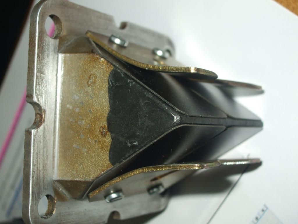

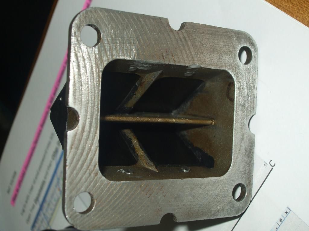

IS THIS REED BLOCK OK FOR A TS1
davyjj
Posts: 6
Joined: Sun Oct 13, 2013 6:03 pm
Main scooter: GP 200 TS1
I hope these pics upload ok....... :roll:
If so, do you think they are good enough to be fitted to a TS1 fitted with a 34 VHSB?????
http://s780.photobucket.com/user/davyjj ... 7.jpg.html
http://i780.photobucket.com/albums/yy81 ... c2ff5e.jpg

It looks like the same one I have on my TS1, but I have a packer plate on mine with a Mikuni 35tmx
looks like yamaha rd reed .. and has been milled to clear frame better .. can use as is with steel reeds
davyjj
Posts: 6
OK thanks! Think I'll stick with it. Seen the exact same one on AF Rayspeeds site so it must be fine. New MB inlet manifold and rubber on its way, so should be good to go :D
