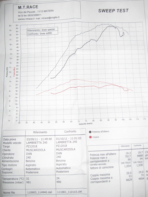

My rt240 has just clocked 5000 km. No problems so far, also under really hot temperatures (40 degrees this summer in south Italy).
Pulls like a train with my Mito reverse pipe and VHSH 30mm (sx200 17x46 , final ratio 4,25). At cruising speed it is also really cheap on fuel (24km/l) and i've clocked a top speed of 136km/h.
These are some dyno sheets, the lowest figures is with a gori 50mm pipe, the other with a Mito reverse pipe.
Is this enough?
