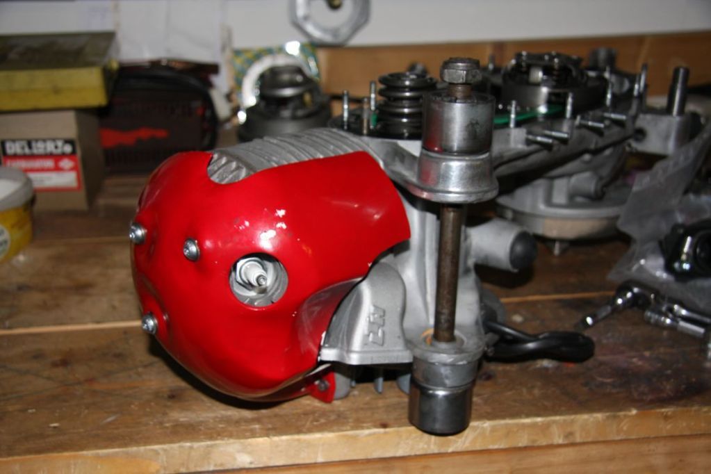

If exhaust arrow is 6 o'clock the pegs are at 1oclock and half way between 10 and 11.
Hope this helps.
Fitted my friends barrel on a spanish case gave right squish with thinnest gasket and good clearance on mag housing.
Thanks mate I managed to get a picture ,just making sure I hadn't fit mine upside down,as 2of us talking when fit and forgot to check ,but I new where the ring pegs were,
I fit mine with the biggest gasket and had to trim the mag housing .Jet 200,looks like lth reed valves all round now though ,more wedge :biggrin:
