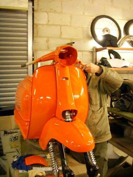

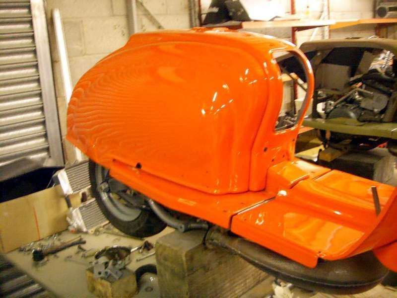

http://www.bpm-grp.co.uk/picture-gallery.php
found these pics for you ..a series 6 frank did ..
if you are fitting series 3 leggies to yours then you will need series 3 rear runners are the s1/2 ones wont match up and will need to close the gap in the side panels also
