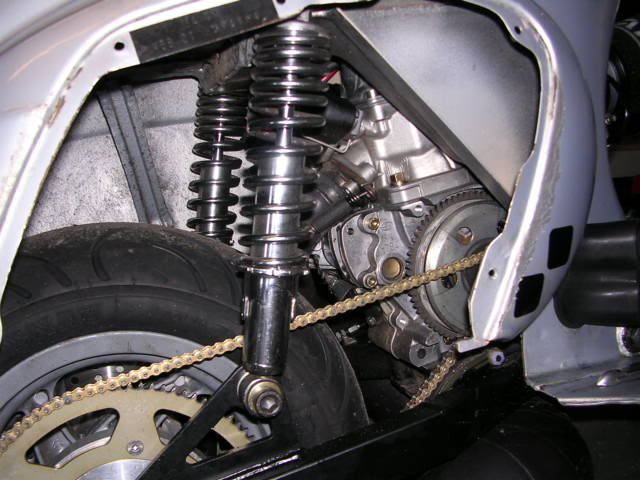

Image http://www.lambrettainnovation.co.uk/vi ... php?pid=23
Theres more pics here my mate was telling me they are doing a swingarm mounted aprilia bike engined 1 like wot you said you wanted to

OzOAP wrote:Image
Oh you beautiful b@5t@rd Oz. Always has been and always will be one of the best Smallframes in the UK.

sweet setup, very light motor
was previously thinking of motors with electric starts, but one of the projects I have been offered for sale is kick start only
how do you guys get around that, surely removing the panel everytime you start it is a right ol chore
has anyone gone to the extent of utilising an original looking kickstart arm from the scooter, then using pivots and linkages make this work the kickstart on the engine?
Image...chain drive ??
usually a kick start extention and removable lever using a 1/2" drive socket
