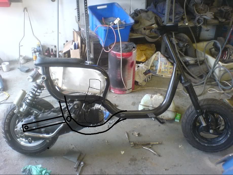

IFi was gonna do a scratch build frame i would be tempted to take the frame tube down rather that up at the bridge section then passing under the engine and then up the back mounting the swing arm from this point if you follow me
bit like an LD frame ric ;)
sommat like this ....
save p1551ing around with cradles(could keep orriginal frame numbers too)
yes sean..... just like an ld ...pity ld iwould be too weak i think
going over your first post again i dont think i fully answered it ,my thoughts on this are that in Oz's case the kart engine had no gearbox and only a small centrifugal clutch to get moving ,as i recall from the right up in scootering it took a while to get going and come on song as it were but back to my point here that the motor used was pretty light and as such diddnt pose much of a problem regarding unstrung weight ,
i think you would soon find the ride a bit strange to say the least also fitting the motor conventionally allows the exhaust to have more fixing point too not to mention stuff like rear sets should you wish to

the whole engine along with the pipes swings on a pivot just below the bridge piece, this has a scratch built tubular chassis to hold the engine, and the original seat loop bolts on top of this.
It's a tidy job. [as are the electrics now ;) ]
