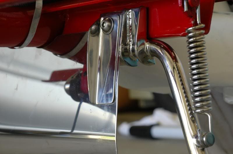

kejj wrote:I have uploaded a STAND album to my dropbox.
http://www.dropbox.com/gallery/259154/2 ... d?h=3ac2bf
There is a tube going right through so I guess the crossmember was welded on the frame by the previus owner.
I need to lift the bike up a considerable amount of height by the handlebars and use my body to push it forward and of the stand.
Anyone?

One side looks bent or its just not sat correct in the hooks..get the wheels of the deck and strip it out and refit it..

Actually it's the angle i photographed from and the floor tilting.

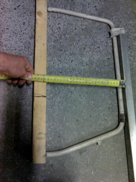

I can see where your problem lies...
Here are some photos;
Does anyone see what I see?
Is there a stop bracket missing there...if yes the stand wont sit in the same position and move about...replace the lot id say and problem sorted.

Hmmmm......looks like the spring side stop bracket has the stopping face welded on the wrong side. Also the stop has been welded back on badly & in the wrong postion. Am I close? :lol:

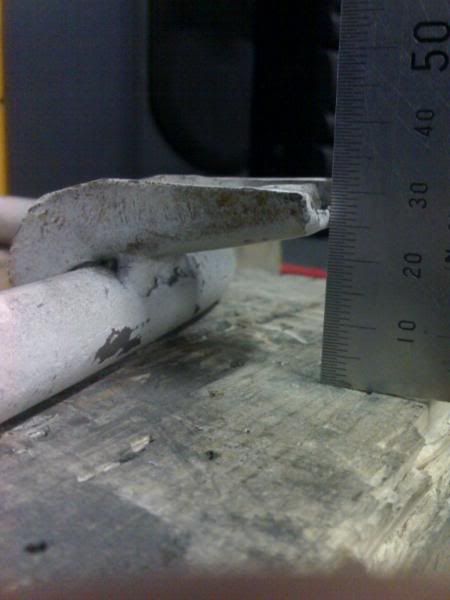

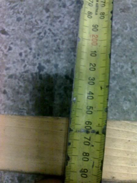

I think you all might be right this time. I toke some more photos:
It seems the former owner did a realy bodge job, The crossmember is on a different position compared to the legshield end on either side.
The stand is to long. The spring is on the wrong side? The stop is on the wrong side?
Can I fix this without grinding or welding? (I don't have the knowledge to or capability)

kejj wrote:...The crossmember is on a different position compared to the legshield end on either side...
probably not then

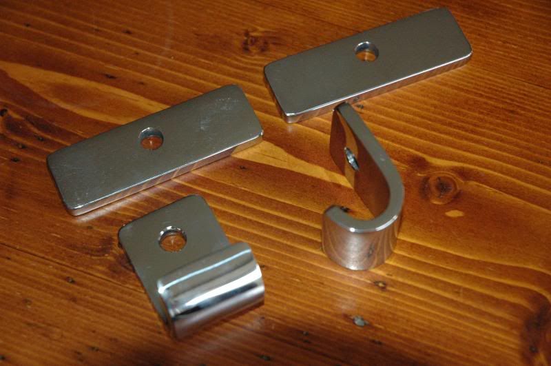

mate, do yourself a favour and order this;
http://www.lambrettaspares.com/sparepar ... 0106k.html

jon wrote:Hmmmm......looks like the spring side stop bracket has the stopping face welded on the wrong side. Also the stop has been welded back on badly & in the wrong postion. Am I close? :lol:
Bingo!
