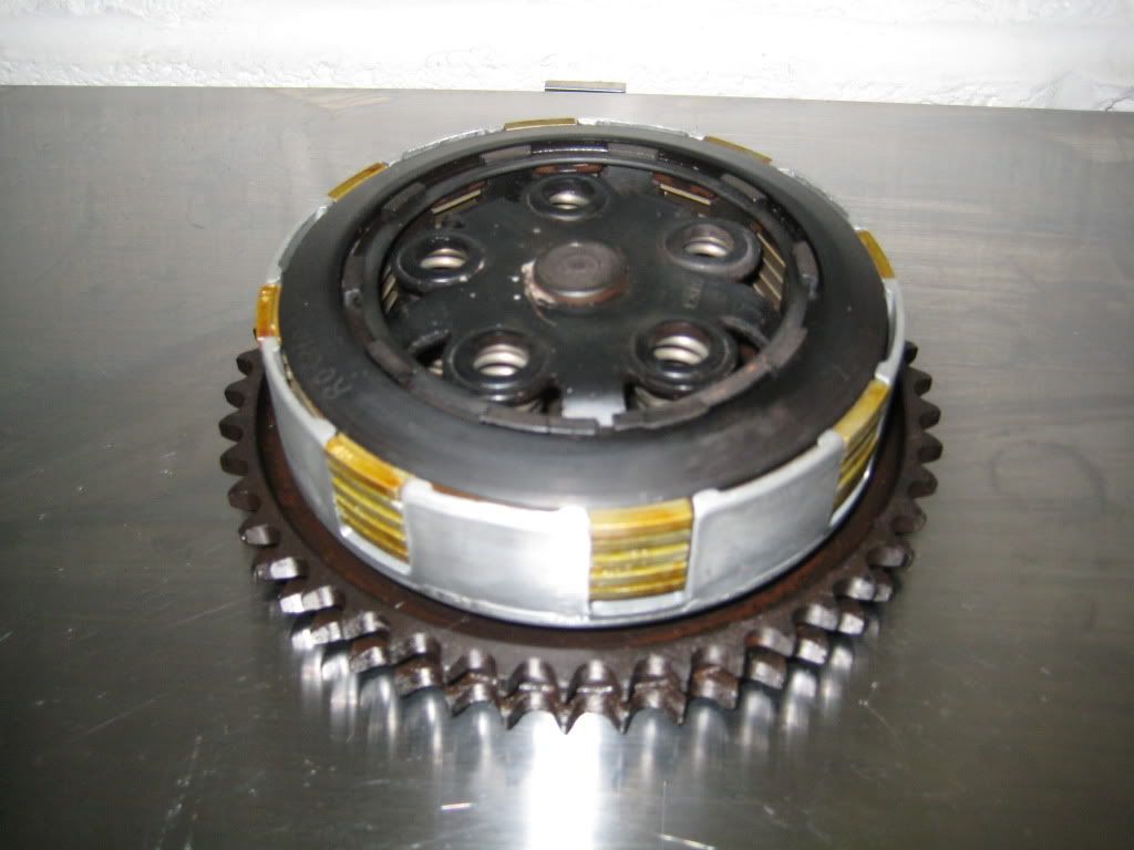

heres my new "normal power" clutch (cr2) which is aimed at standard to mildly tuned bikes , it currently being fitted to my 24 bhp engine so we will see what happens ! , i think pricewise you will be looking at around £150 , as for by 6 plate full power (cr1) im currently sorting the first ones out :D
Rich_T
Posts: 540
Main scooter: Li Special
Location: Birmingham
Looks smaller than RS125 plates and 8 tabs.
Are these clutches now based of Lifan 125cc Monkey bikes parts like the Siagon one?

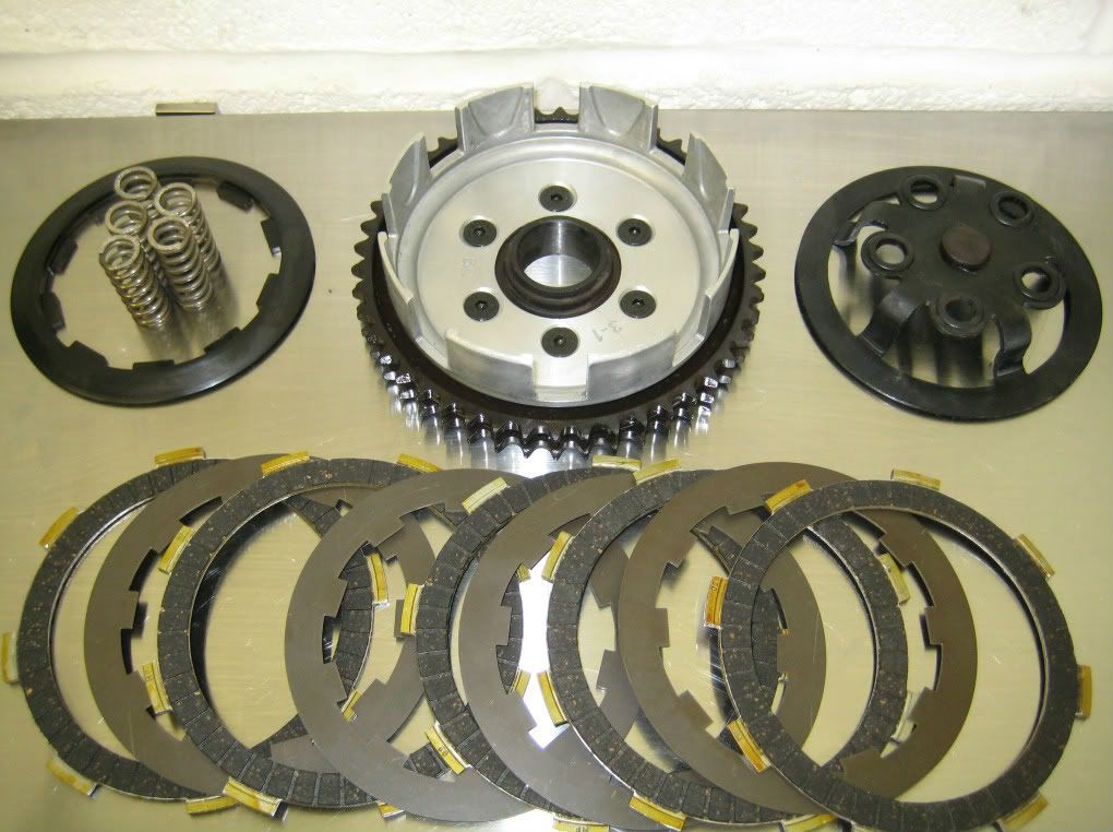

quick update i pulled my motor today to change the drive side oil seal and thought i would check the clutch out while i was in the motor, i am pleased to say there was no wear at all after a very hard 600 miles on final finished unit
roch68's clutch after 600 miles with no wear by mark & anne's photos, on Flickr
on a by note the readspeed 6 plate i was running needed changing after 500 miles as it was worn out , saying that jerome did say that its not designed for a 40bhp motor so i was happy to change as and when i needed to.
