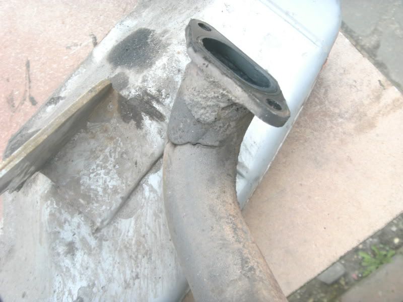

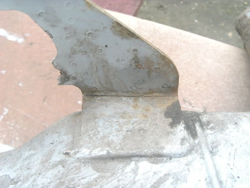

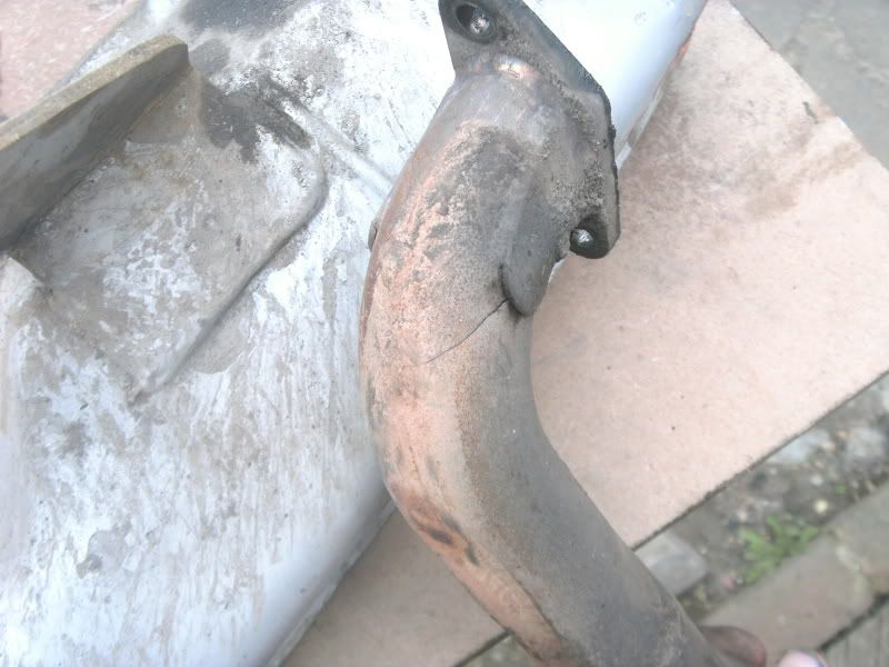

There are real problems with the quality of the steel used to make the brackets. The one I repaired was like chocolate: you could "peel" the bracket off the body of the silencer with a screwdriver. Utter rubbish.
I understand that not all are of the same quality, but someone should be ashamed of themselves for letting this batch escape.

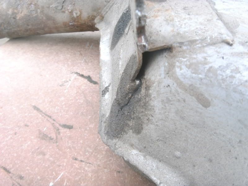

Havent had a chance to weld it yet but looking at the bottom chain case bolt hole that has just dissapeared it doesnt look of great quality.
As I've said it came with a scoot, so not too bothered, I'll reweld it and add a bottom bracket and maybe a tail pipe bracket, see how we get on with that.
it should have had a tailpipe bracket, a loose clamp, rather than being welded to the pipe. Maybe the lack of that wasn't helping it all stay together...
