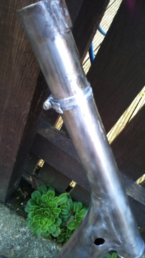

Want to cut the headstock down on an LI frame to take GP forks, how much do i need to take of and what methods have people used(industrial pipe cutter or hacksaw)

i did this -
carefully making sure clip is seated square to the tube cut with a fine toothed hack saw careful cut a line round as far as you can go ,turn clip to line an completely scribe round then cut propper ,either then have a top cup turndown to fit the head stock or use a chrome ring type and have a sleeve made
dont forget you will need to reposition the steering stops and steering lock plate

do you know how much diffrence there is between the two
Leigh
with out mesuring it would be off the top of my head ..1.5" i think ,there is a list on here if you search of fork stem and headstock lenghs
