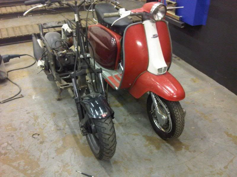

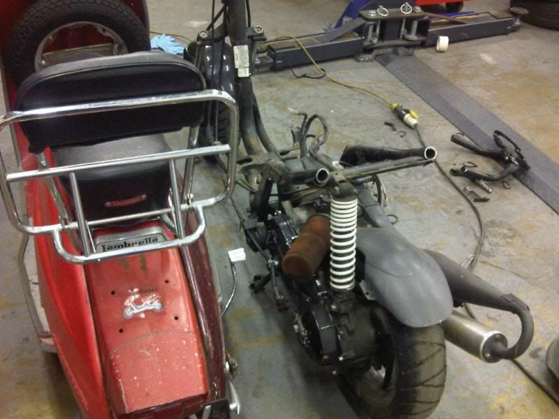

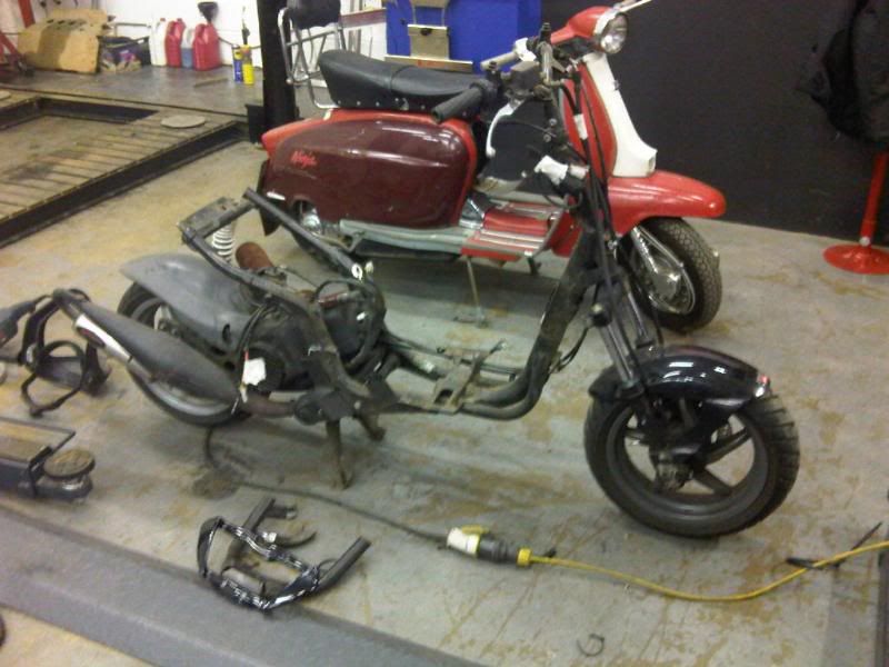

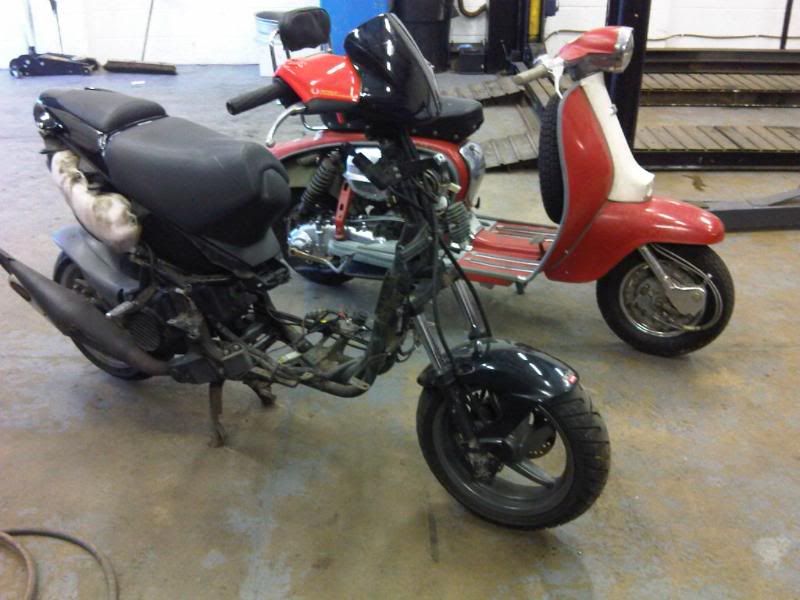

My plan is to make a GP rep out of a SR 125/172 i've had knocking around. Looking to do it on the cheap so using as much of the SR as poss including frame, reg, forks,wheels etc.
NO LAMBRETTAS WILL BE HARMED DURING THE BUILD ;)
click on the pics to enlarge

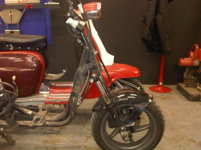

next step is legshields,mudguard and hoop to get it lining up.May shorten the fork legs but will have to see when i get the legshields etc mounted

Having bodged about with an sr 50 you will find that the sr forks will hit the legsheild and a lammy mudgaurd will not clear either ,now I ended up abandoning the sr frame in favor of a fattspeed Frame but as I was doing a cutdown style job the cutouts that were nessasary with the sr forks could be used for the rads and I intended to use the standard sr mudguard any way ,if any one can stick a link to the 180 streetfighter thing as the computer is fooked and I am posting this via a bloody iPod ,when I can I post some pics of butchered sr :lol:
