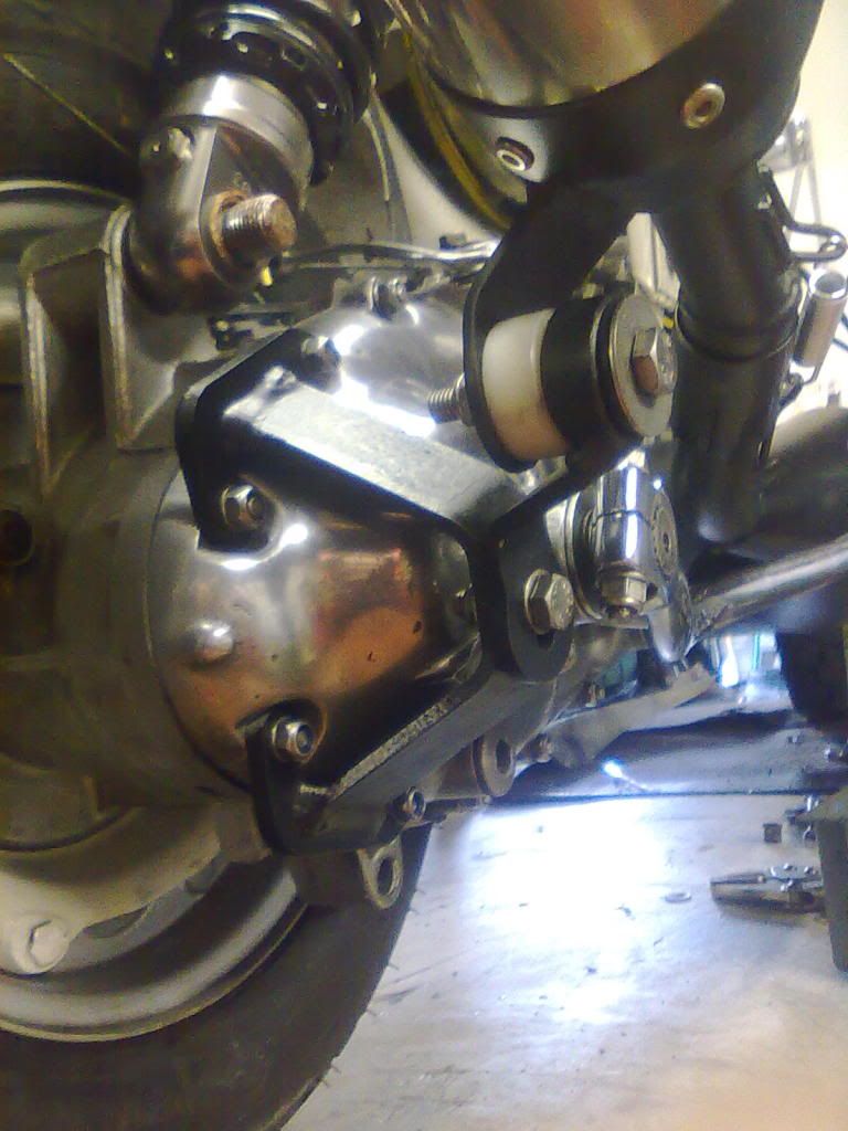

MBD Devtour bracket on a JL3 End

hydra wrote:Image
Similar to mine. But I use a Devtour bracket and end can on my TS1/JL4

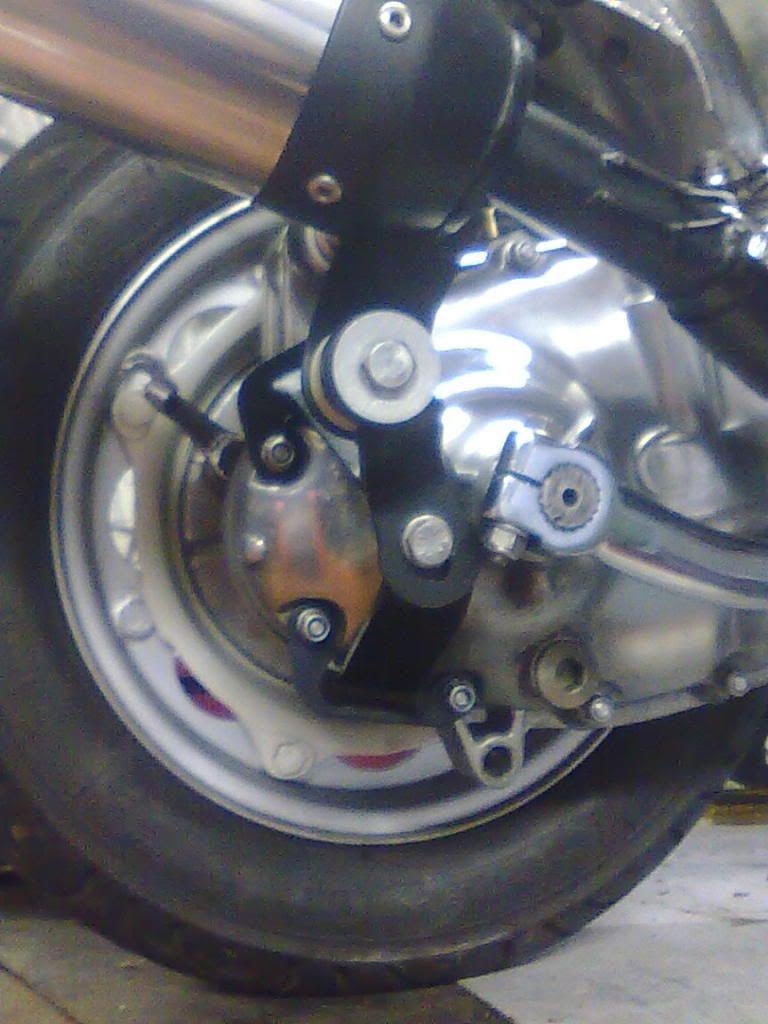

another view of MBD Devtour bracket on JL3

hydra wrote:Image
That looks a bit more substanial :)
Do you have too get extended chaincase studs for the mounting bracket?
Also do you know how much and can they be purchased seperately?
