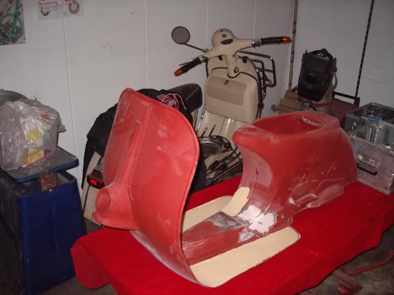

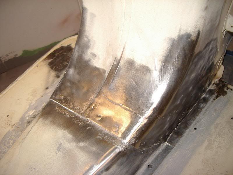

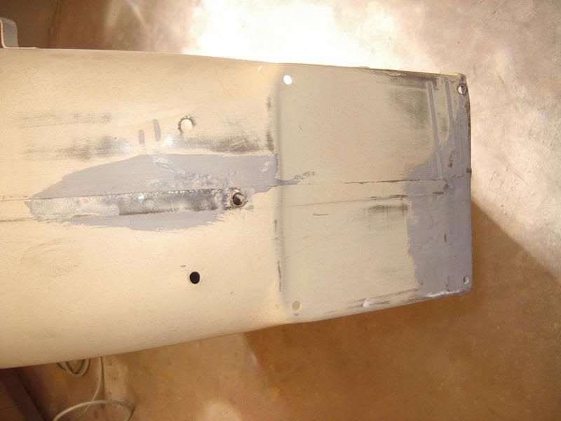

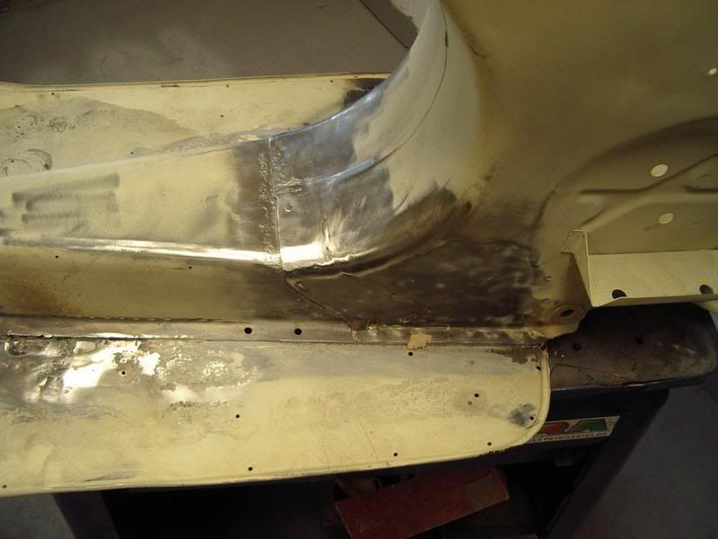

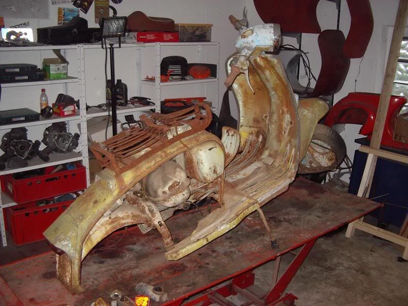

I Part exd this Vespa GL for an LI3 that id just finished, the GL was already stripped and had already had a bit of welding done too it by a well known scooter shop in Germany, most of which needed redoing and tidying up, Ive finished the prep satge and have just started rebuilding. Im in the middle of polishing all the ally bits and the motor still needs putting together
The Lammy that I part exd...just been offered it back as the buyers run out of cash and cant afford an engine :roll:
Before:::
After...sold without engine ;)
The pile of bits that I recieved....
Frame;

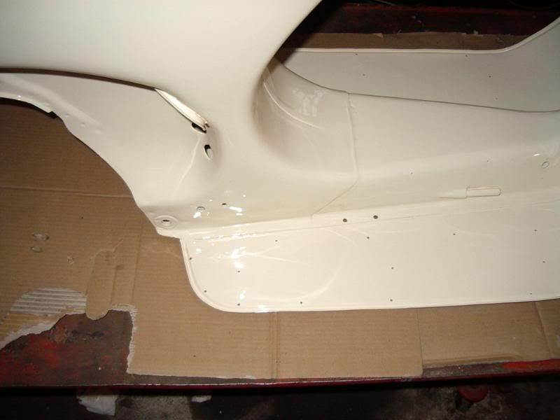

Looks like a lot of filler on the floor, its really a very thin skim to cover small dents, most of it disapeared after sanding.
After Painting; It had to be sprayed twice, the first attempt was a bit rough, all the seams around the horncover had been filled in, quite happy with the new respray now though.

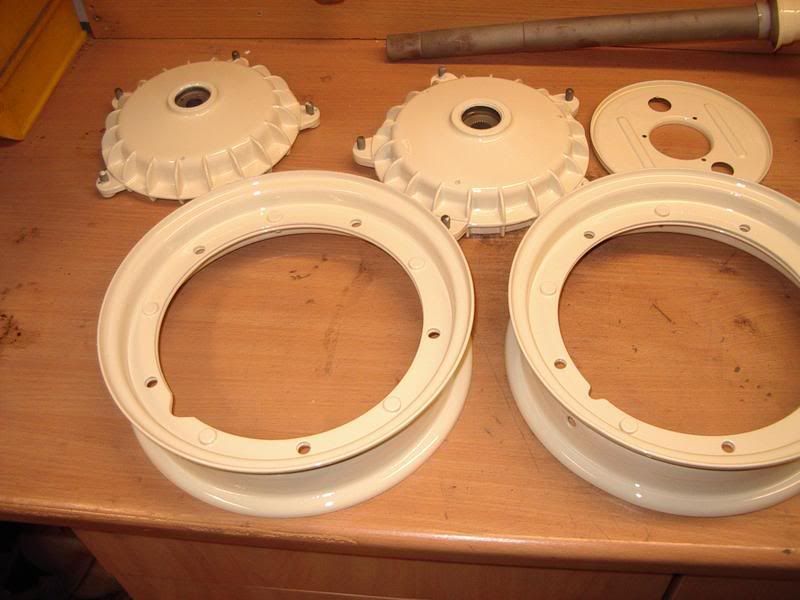

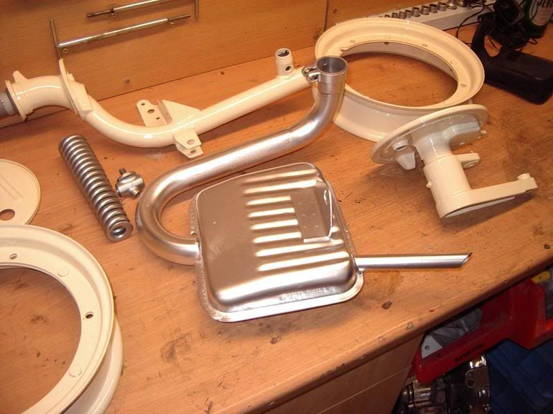

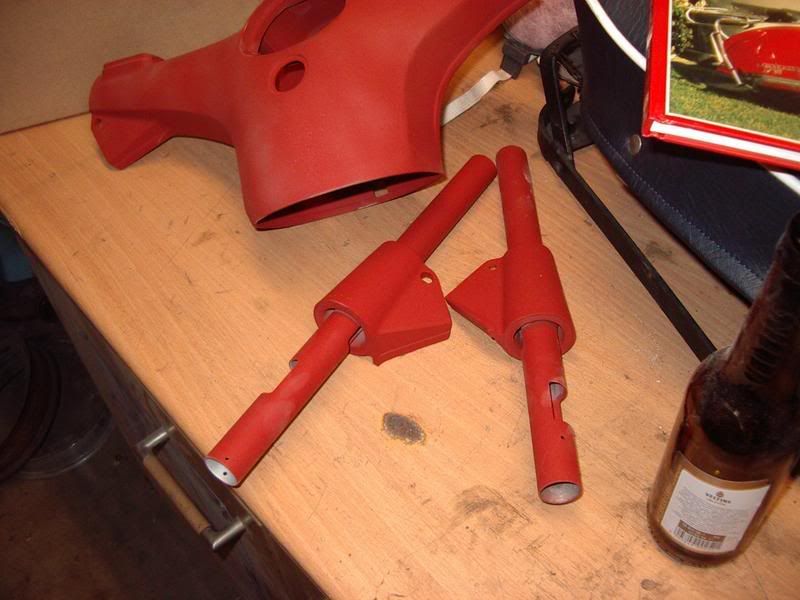

Forks have been Powder coated, along with the wheels, stand, hubs etc...

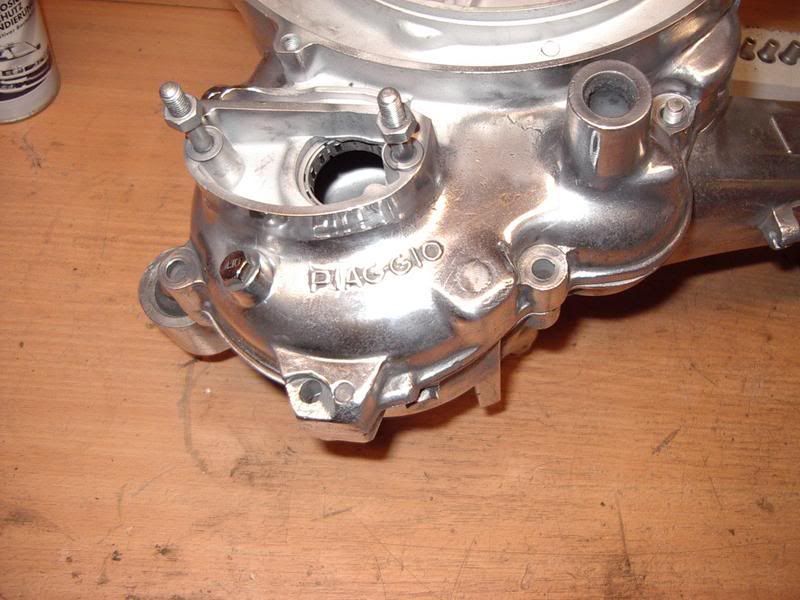

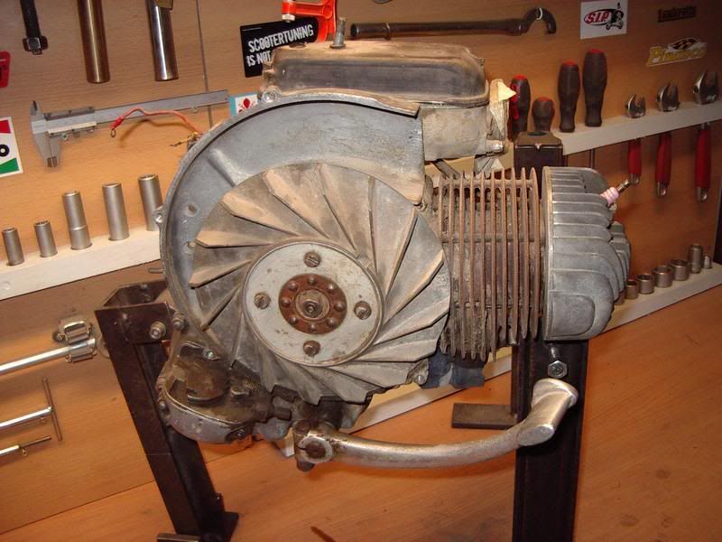

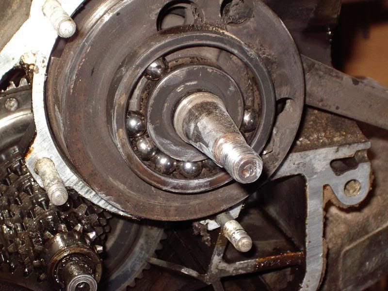

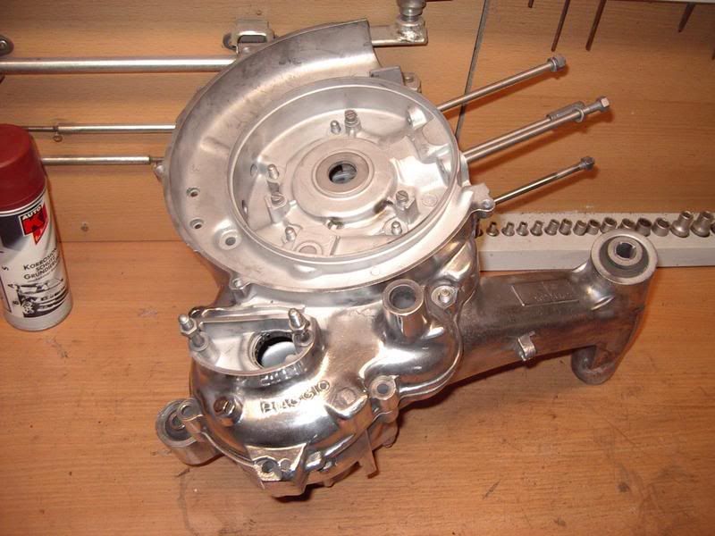

Ive stripped the motor, cleaned everything up, havent started rebuilding it yet...

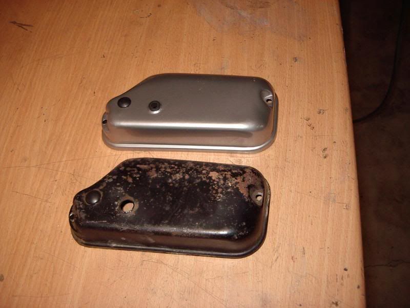

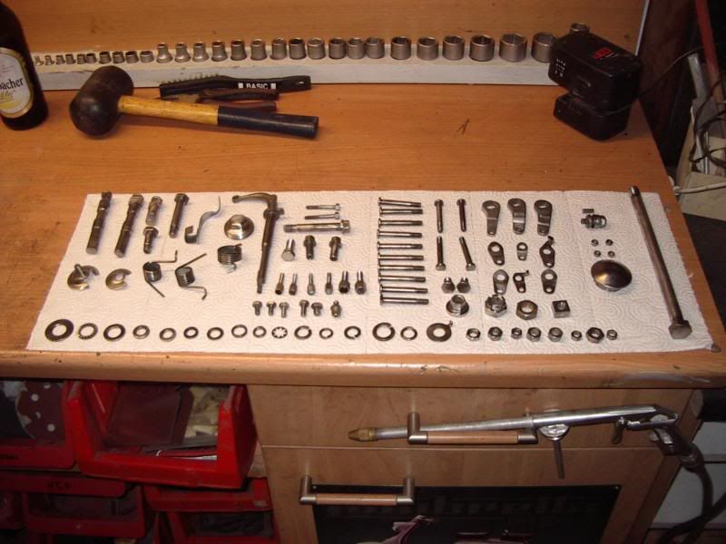

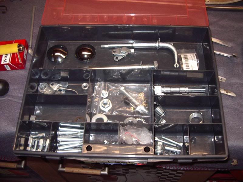

Had all the original screws, bolts etc redipped in zinc or chrome...Im trying to reuse as many parts as poss...

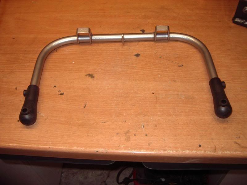

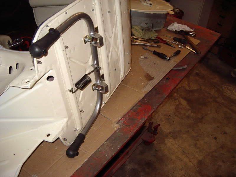

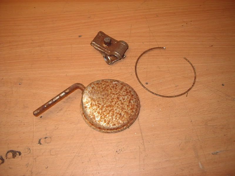

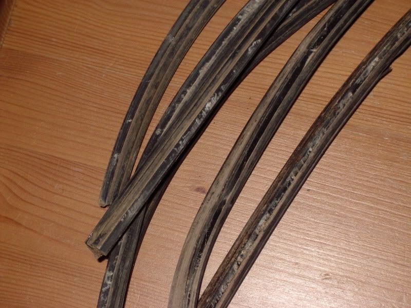

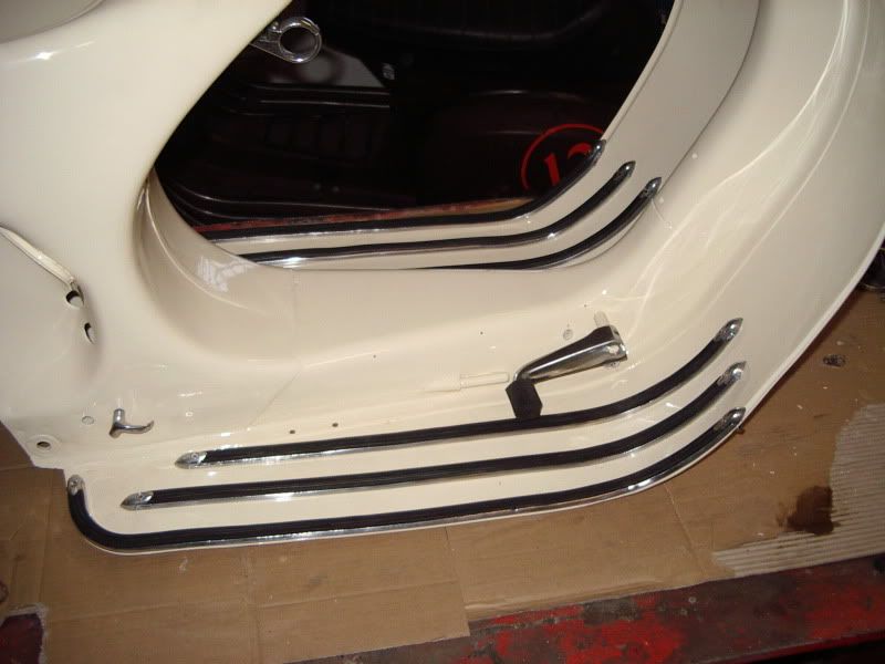

I havent had much time lately to do much on the GL. I fitted the Stand, brake pedal and runners last Saturday, the runners took about 8 hours to get right.
I resused the original runners and rubber strips after finding out that the remade ones Id bought are completly the wrong shape.
The original ones where a bit bent and had a lot of ally corrosion, took about 4 hours to get em sorted and halfay decently polished.
Stuck the rubbers in the dishwasher and gave em a Polish afterwards with Shoe polish, turned out well.

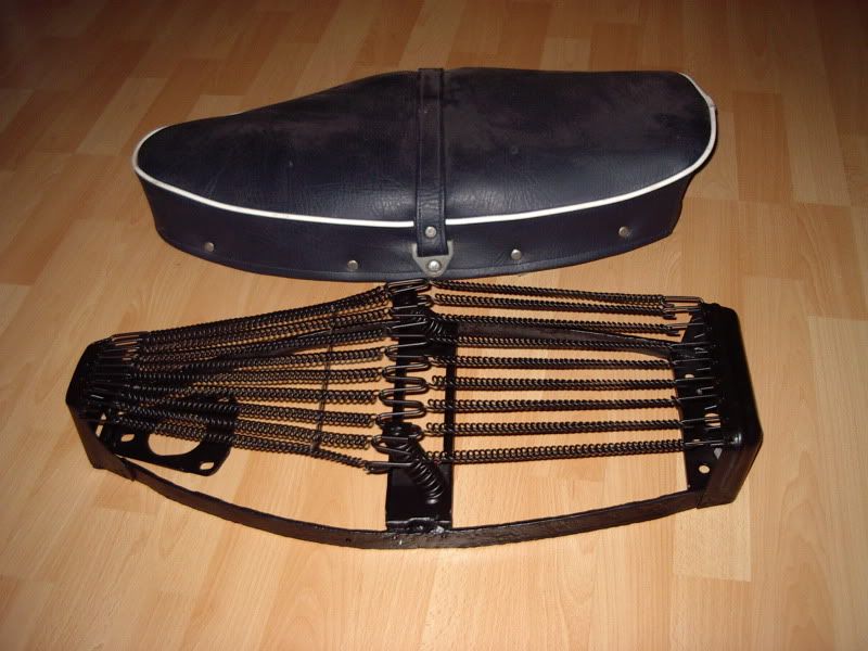

Done quite a bit on the seat as well, the cover needs to go back to the saddlers as it doesnt quite fit, (its not high enough).

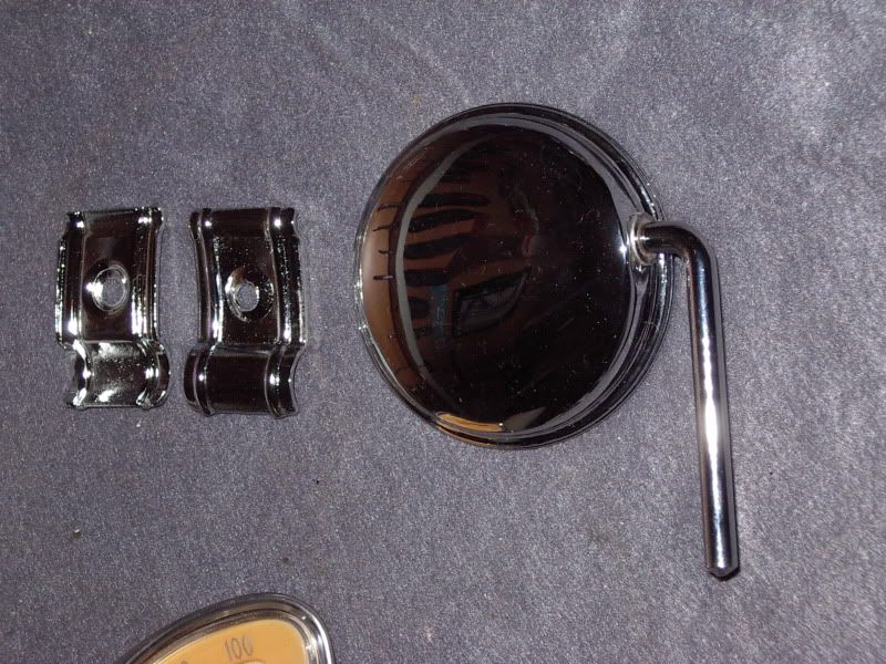

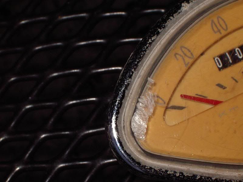

Also got a few bits back from chroming, the mirror turned out ok but ive now got a gold plated headlight rim......if anyone wants to swap for an original undamaged chrome one give me a shout ;)

challenger wrote:Image
Stand feet rubber are in the wrong position.... :lol:
nice job ;)
