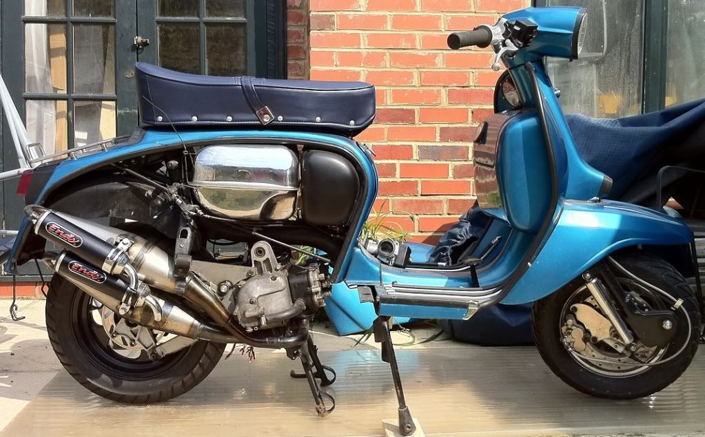

Hi I'm really hoping someone out there can answer this.
Has anyone put an italjet formula 125 twin into a lammy frame.
Do you know anyone who has or even seen one???
Basically been wanting to do an auto for a while now, I have a
Frame where the engine mount has been welded on several occasions
And cracked again, the numbers aren't readable any more so I thought
Why not..... Couldn't get hold of the typical auto but the twin came up and
I thought I'd give it a go.. The main difference that first comes to mind is that
All the usual ones I've seen use engines with the mounts underneath...
The twins are on top.....?
So was gonna use the italjet frame at that point, to weld in??
Any ideas, picking the engine up Saturday...

Thanks guys for the suggestions I just fancied the twin as it sounds great and hopefully I won't have to do any major frame chops to do it, weld on mount on opposite site for rear shock. I've got the twister now and whilst my Ts1 is out of my gp I'm gonna sit it in there. I'll post some picks when I do it, if it turns out to be too slow, I'll do the runner engine instead... :anbrgin;

The rear runner struts fowl so will definitely have to remove the exhaust side one, then the engine should fit nicely, engine mouts and length of engine is virtually the same as a Lambretta engine, engine bolt thinner and gap between mounts is 38mm wider, with no rubber bushing but a bearing..
