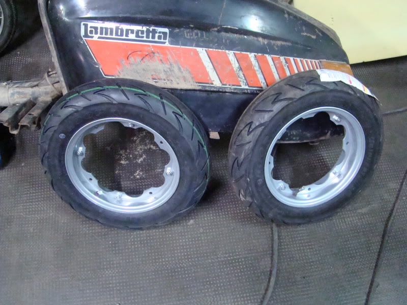

my lince combo
left the 350.10 on standart rim , right the 100.90.10 on wide rim
no problem with the 100.90.10 on the rear
