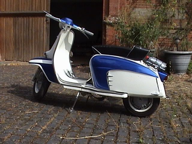

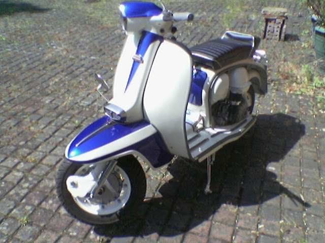

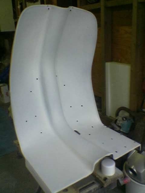

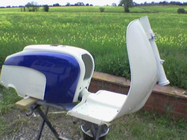

All good advice above but it isn't necessarily the cheapest way to do it, I reckon I spent well over £100 on primmer, base coats and lacquer when I did my LiS a few years ago. It turned out really well but as previously mentioned, petrol resistant laquer is a must on the hoop, panels and rear runners. In fact anywhere petrol might contact, I didn't realise that acrylic was affected by petrol until the first overfill :cry: I made the mistake of trying to wipem the petrol off and took most of the laquer off on the paper towel :shock:
The real sectret to a good finish is getting the surface really smooth. As mentioned, use spray filler over any repaired areas, make sure you feather out the edges and don't put it on too thick. Build it up slowly and flat with 600 wet & dry. Put 2 or 3 coats of primer over the whole area to be sprayed and flat it with 800 wet & dry making sure you get rid of all traces of orange peel. Use a VERY light (guide)coat of a dark colour over the primer before you start flatting (hold the can about 18" from the surface, all you want is a speckly coat) as you flat the guid coat you will easily see the low spots and minor blemishes which if too deep will need cellelose stopper applied. When you have finished flatting you should have a perfectly smooth finish ready for your colour coat.
Here's a few pictures of mine:
