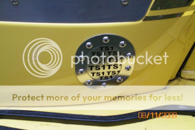

How about this one on my RB
sydduckett
Posts: 1900
Cheers carlos, looking for the sort that has a scoop but i guess that gives same result.... :D
