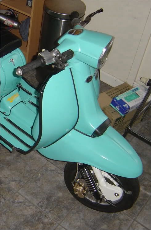

Has anyone used any other makes of front dampers apart from the kawasaki ones.
Are there any Gas/adjustable ones on the market that will fit a lammy?

I've got BGM Fronts on two of my scooters and they are superb! the best standard looking ones imo are the AF ones but BGM are adjustable are definitely a step i the right direction.

theres plenty just depends if you wanna modify your forks or links i used an external conversion from frank sanderson on my gp ,the extra width that these have gives better road holding i found them great with a scootrs disc infact i have a second one that i no longer need as i have sold my scooters
if your gonna have stiffer dampers be carefull that there not to stiff as they can damage the mounting points or even rip them off as the standard ones are only 6mm, serveta fitted heavy duty dampers to the later 200 range these have 9mm mountings for that very reason and the external conversion uses 12mm
