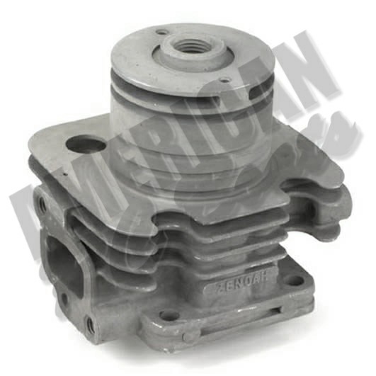

If I was attempting to make a one off barrel for bigger cubes, then I wouldnt run the studs the length of the barrel, I would fit short studs that bolt the barrel with a flange to a modified case, allowing the space that the long barrel studs would take up to be used by additional transfers or more space for cooling fins or a water jacket.

oh i get ya. not a good example but like this:
yes in the same way as some small frame kits ar fitted
another thing to think of is that lammy run the bore horizontally unlike most others
