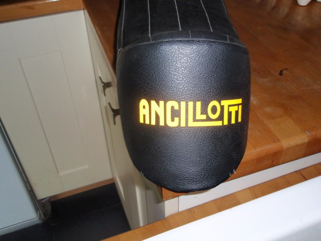

I had the same problem with one of my seats , but as Im in the print trade I got hold of some high tack exterior quality reflective vinyl and contour cut it in the Ancillotti logo style.
The vinyl sticks like sh*t to a blanket and safety wise when cought in car headlights it reflects bright amber ,it looks very cool 8-)

Very clever that Blue Peter yellow sticky stuff!! neat job bro!!

I like ripfx,s stick on ancillotti, looks good, will it last.

eibargum wrote:I like ripfx,s stick on ancillotti, looks good, will it last.
It should do as its exterior grade, Ive had a sample on another seat that been used on a winter hack in all kinds of weather, its still fine, no lifting edges or creasing so far.....

you have made an excellent job of that :D
