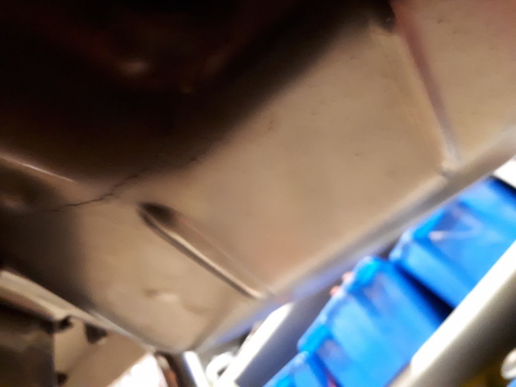

just putting my bike back together after a big winter overhaul and noticed this. I'm sure it was fine when I took it off, but I guess I wasn't paying attention as it's only been run for 5 minutes since rebuild to set timing.
what's the best course of action? get it brazed? I suspect it will just crack again, but it'll be a canny bit cheaper than getting a new pipe (£200 plus they have none).
I would go for a gori race 50mm but they're £300!

i would weld that up, and put a patch over it so it wont split again, i guess it must have been a bit tight when fitted and the vibrations have split it, dont suppose your coming anywhere near hull so you could drop it off ?

If you weld make sure to stop drill the ends of the crack or it will.continue to crack

No, it's a bgm so their mounting arrangement make them stress-free. Otherwise I'd have concluded the same thing. I can't really understand how it happened.
I never get near hull these days but thanks anyway. It's due a dyno session as I've had the barrel and head modified plus a 60/110 crank. So I'll see if Mick Abbey will kill two birds with one stone. He's only a 30 mile ride from mine.

How old is the Clubman?

I put it on not long before the breighton ferry rally last year, but I'd owned it since at least a year before that. It spent a long time under my bench.
I'd guess that it's covered around 1000 miles.

If you want to send it to me I'll repair it for you foc, I'm getting good at welding up clubman exhausts.

Scooterdude wrote:If you want to send it to me I'll repair it for you foc, I'm getting good at welding up clubman exhausts.
What a smashing fella.
Pm sent

Thanks, I did think about that but the engine is nice with the bgm and has a much larger downpipe so I think the rs may hold it back a little.
Plus there'll probably be a bidding war on that.
