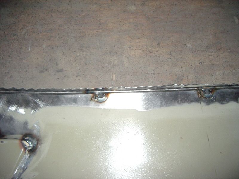

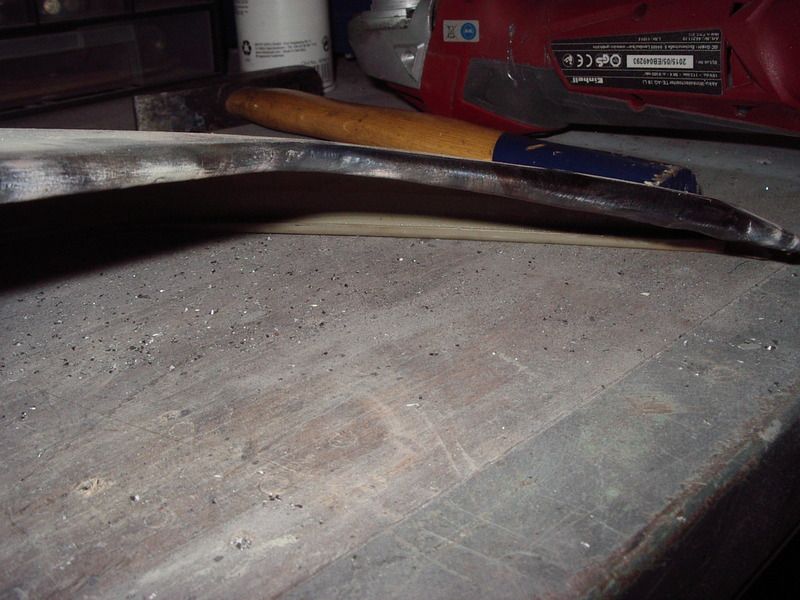

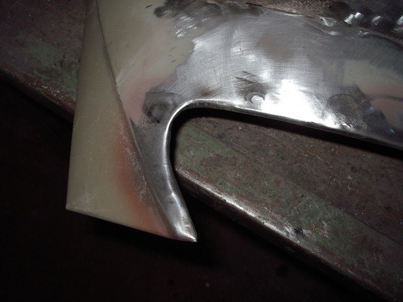

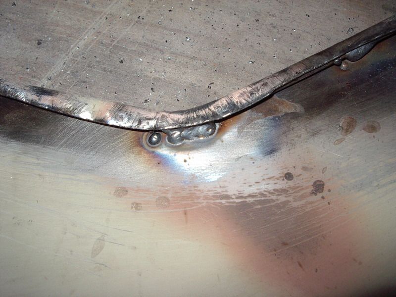

I’ve just finished doing this to a sidepanel today.
If you can weld, you can do it yourself.
If you cant weld, you can do all the other work required yourself to keep the cost down.
I took some photos of the work in progress which I can up load for you tomorrow.
Basically, you need to cut the Panel out first.
Take a 4mm steel bar and bend it to the shape of your cut out, the rod needs to sit on the inside of your sidepanel about 8mm above the cut out.
Weld the rod onto the inside of your panel. (Spot welding is strong enough )
Heat up the edges of your panel a bit at a time, (about 5 cm at a time), use a pair of big pliers to take hold of the edges of the panel and the steel rod and bend the panel edges up to meet the steel rod.
To get the panel edges around curves, use lots more heat and hit the panel edges with a hammer.
Last step, heat about 5 cm at a time back up and hit the edges with your Hammer to get rid of all the little creases and folds that came from using your pliers.
You should have, by now, nicely rounded off panel edges.
Dont forget to Sand or file the edges on the inside down a bit to get rid of any sharp edges.
Hope that I’ve explained it enough to be of help, if not, wait for the photos.
challenger
Posts: 92
Joined: Mon Jan 25, 2010 7:08 pm
Heres some photos for you.....

Thanks guys, was my First attempt and im quite happy how it worked out.
