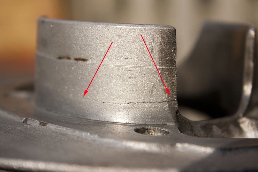

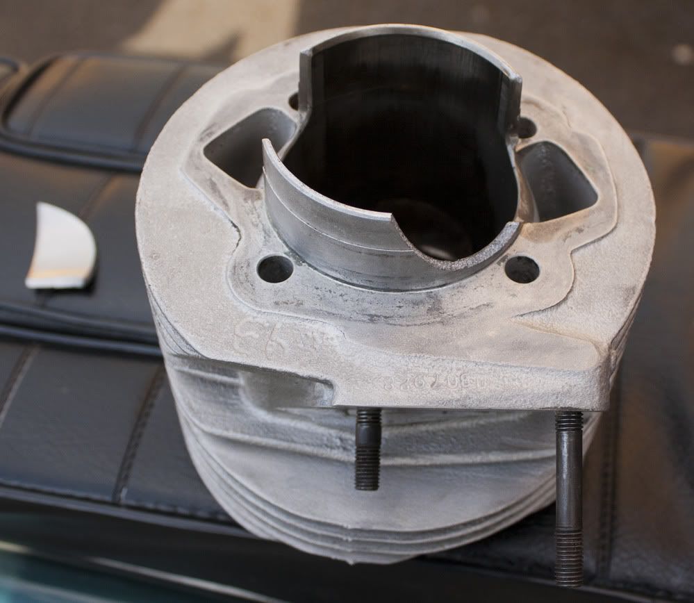

Right been round my mates tonight to have a look at this as he wasn't describing it very well.
Story is he'd noticed that the muggy (V3) was blowing and ended up having 3 of the cylinder head to cylinder threads helicoiled.
In the process of putting it back together (has to be said he's never rebuilt an engine) he said it wouldn't go any further, gave it a few taps, still wouldn't budge so took it off again to see what was going on and part of the spigot fell off, obviously where he'd cracked it.
I suspect he whacked it but he's not admitting such!

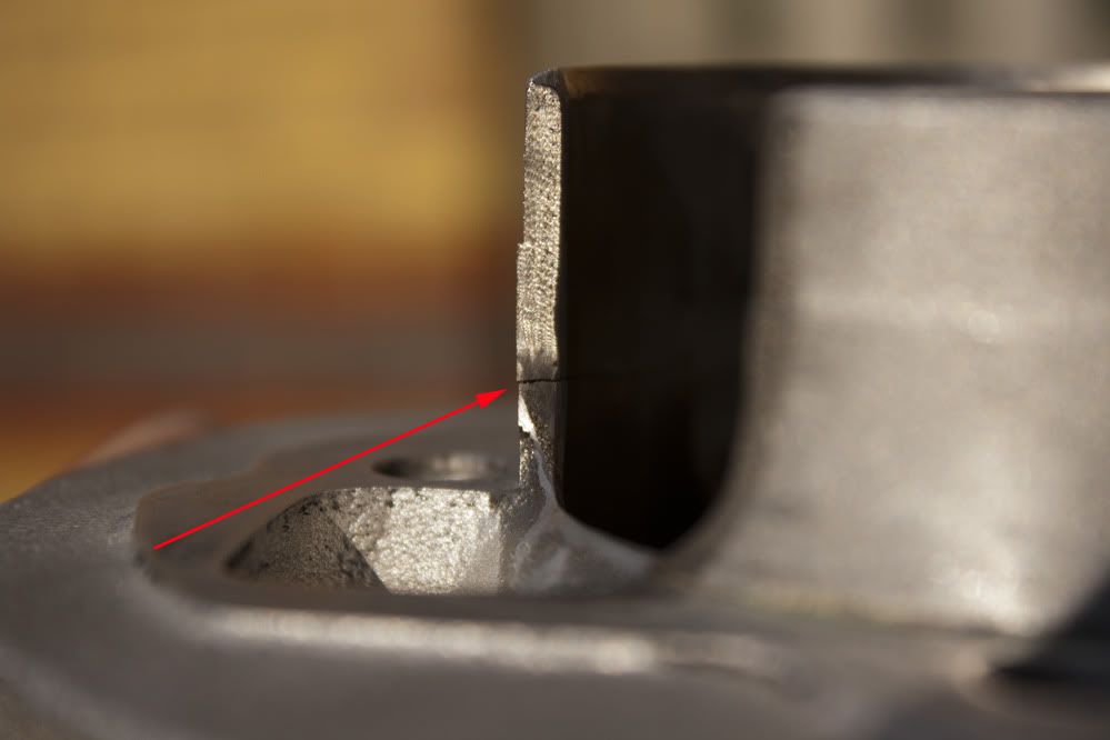

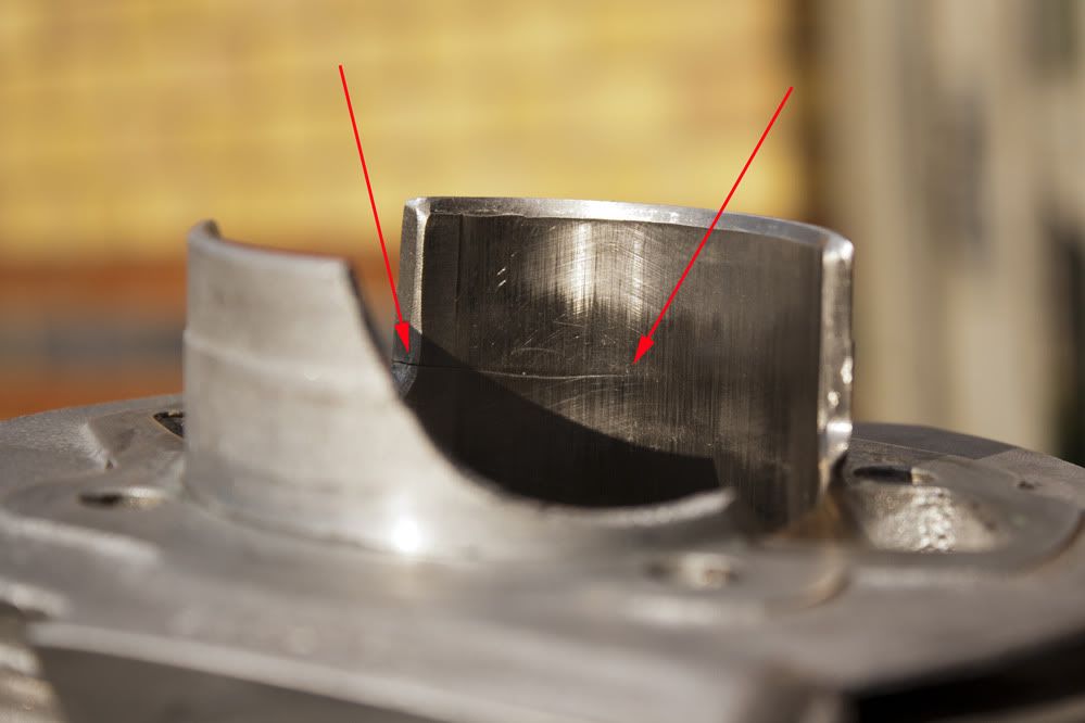

However on closer inspection there's a crack on the other half of the spigot too! you can see it in the following pics.
So I said I would post the pics and gather opinions?
Donnie.
fooked unless you have a steel liner fitted that will become the spigot

may as well just have a different kit rather than faff about with that surely?

there are only 4 studs to the casing
i think hes saying the threads in the cylinder top gasket face were re tapped
Just a thought but when he had the helicoils done is it possible that some numpty held the spigot in a vice :o might account for the damage on both sides
